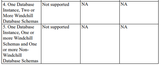

there is another detail to our installation: we already have a previous version installed on the same host and are trying to add another user to the database. i wonder if this is even doable
apriori-it
(To:apriori-it)
how do we have two tablespaces in one database.  In order to upgrade, ptcs customers have to be able to so something like what i am doing so that they can make the old / new database conversion.  I cannot believe that we need to install a separate server or separate database application.

Hi @apriori-it
Have you ever read instalation guide?
The PSI do not support to install your second Windchill DB to the existing one.
I can imagine that you install it to an another instance and move the new database to existing one after Windchill is installed. but I can not recommand it.
PetrH
@HelesicPetr  thank you, that explains our failures!
