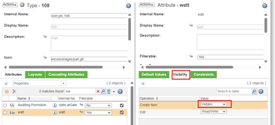

When I create a new document type in Windchill's Type and Attribute screen, there are default attributes that appear in the Create Layout screen. How can I remove these attributes from the layout screen?

This attributes are Inherited from a patent type , they can be removed from there .
Otherwise you have to create layouts for that subbtype, Creating a New Attribute Layout
Do Not do this diretcly on a prod sytem , before fully validating on test server

As @Fadel mentioned. You have to remove all attributes from the root type layout and then specify the attributes on each sub type layout.

if these attributes are needed in other sofrtypes we may try to hide these attributes visibilty on that specific type :
