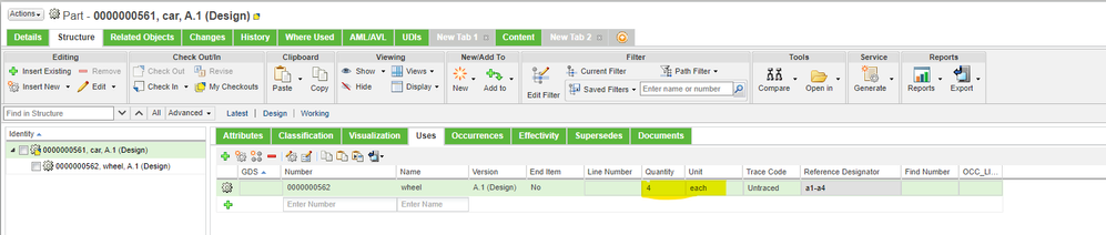

partUsesoccurences holds info on the occurrences (generally reference designator /location [geometry]), this is needed particularly when we have usageLinks with Quantity > 1 and unit equal each , like a car with 4 wheels , we can have one Usage like with 4 ref designators to have 4 occurrences to identify each wheel

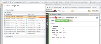

Not possible using OOTB Query builder :
1- It not support recursive calls
2- the structure resolving requires a config spec (filter) , not possible using QML

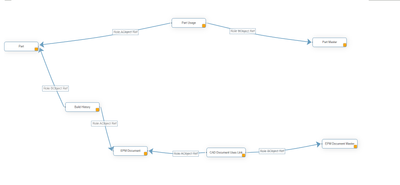

The issue is not on the link , the issue is on traversing the structure from BOM header to leaf .
just for parts the link between a parent part and a components is WTPartUsagelink  this one has a role to parent WTPart and the other role   to child
is WTPartMaster , in this case how you are going to resolve child WTPartMaster to WTParts, you need a filter (i.e. latest,baseline.....) there is no way to apply the filter using QML or SQL .

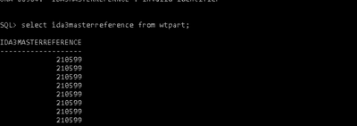

The WTpart has a column called ida3masterreference that holds the ida2a2 of the WTPartmaster
The same applies for EPMDoc it has ida3masterreference with ida2a2 of the WTPartmaster
regarding  Part structure , the link is WTPartUsageLink the has 2 roles one is parent WTPart IDA2A2 ,the other role is ida2a2 of the WTPartMaster of the child

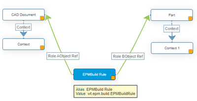

EPMBuildHistory has two roles one is to WTPart, the other is to EPM
The links are like this, my question is still how to make this play recessively and resolve masters to iterations

But at the same time I also understand that one CAD structure can be referenced to multiple parts structures Or multiple part structures can be derived from one CAD structure. And therefore multiple part occurrences can be derived from one CAD occurrence. Having said that I wanted to check whether the build that we do from cad to part is occurrence to occurrence build or just CAD to part build
