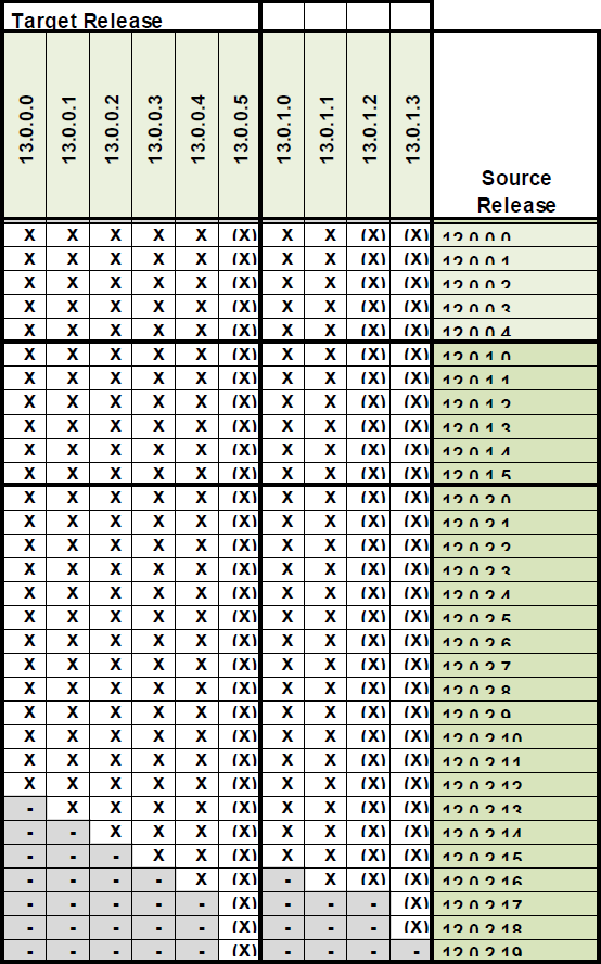

update windchill 12.0 to 13.0 Upgrade Manager Verifying Upgrade Path FAILED
永贵_10723545
3-Newcomer
Verify Supported Upgrade Path has found errors.The upgrade path for the source system is not supported for an upgrade to this target system. The following required solutions on the source system are at an invalid release level for this upgrade: IE
Hi @永贵_10723545
So you need to find the correct path. For example update to the latest CPS and upgrade to wch13 or
two phase upgrade to 12,1 and then continue to 13.0
Or you configured something wrong for the upgrade.

All versions of 12.X are valid for upgrade to 13.0.
Either you did something wrong in the upgrade process or you can try a newer CPS of your version of 12.x.

Guy,
Get this.
I install 13.0.0.0 and then later tried to apply Patch to go to 13.0.1.0.
It was a no go, stating to upgrade path was not supported. Whaaaat?!
I then did a full fresh install from scratch of 13.0.1.0.
I have been able to upgrade 13.0.1.0 to 13.0.1.1.
That said, my guess is the solution here is to upgrade from 12.1 to at least 13.0.1.0.
And yes, I’d agree to check supported upgrade paths and install the latest supported CSP on 12.1, if for no other reason than to make sure you’re using the latest and greatest WinDU/WinRU.
My two cents. Which is probably worth the same.😂

(To:永贵_10723545)
Here's a link to the document being mentioned:  WindchillSupportedUpdateUpgradePaths.pdf (ptc.com)
It's a bit of a pain to read because the text is too big.  With a little manipulation in Paint, here is the relevant section:
