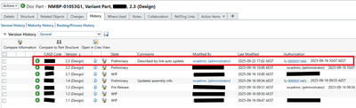

We’ve recently discovered a behavior of the wcadmin user related to Describe by document update.

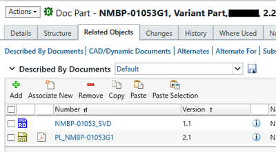

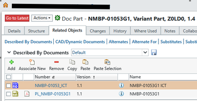

1. We created a Doc Part NMBP-G1 with Releasable Describe by document NMBP-ICT for its first version.
2. Upon release, it has the “NMBP-ICT” releasable document and a Releasable Report (parts list) linked to it. This is normal behaviour and what we expect to see.
3. Then I revised the Doc Part NMBP-G1 to version 2.2 via a CN and replaced the “NMBP-ICT” document with a “NMBP-SVD” document as the describe by document.
4. Then This Rev 2.2 of the Doc Part NMBP-G1 and “NMBP-SVD” document were then released.

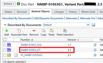

5. For some reason, We updated the previous describe by document NMBP-ICT and released on a separate CN. Upon release of Rev 2 of the “NMBP-ICT” document, wcadmin user adds the Rev 2 “ICT” document back in as a describe by document automatically to the original Doc part NMBP-G1 without notification. and also rev up the Doc part to version 2.3.
The history of the Part shows "Describe-by link auto update" .
This is issue for us. We want windchill to stop doing this. or at-least send notification to the subscriber of the part. I hope I have explained the issue. I cant provide the full snap shots because of security reason.

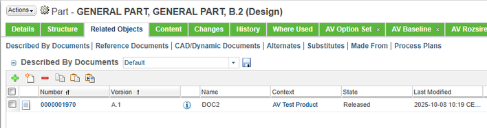

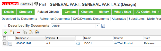

I test it. If I release the revised doc2 that is not part of the last wtpart iteration, the describe by link is not autocreated to the newest one.
DOC1 linked to the old revision
In the WTPart version B.1 I removed DOC1 and added DOC2
everything has been released.
latest WTPart with only manually added document
first document was also revised to new revision and released by an ECN
Then I revise the DOC 1 and release new revision. The latest iteration of the WTPart is without any system admin change.

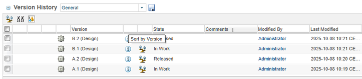

WTP history table
HelesicPetr_4-1759912270912.png\
Conclusion your system could contains some customization to do what you described.

Hi @KS_13883962
I can see that the iteration comment is Describe By link auto update.
I haven't seen this behavior OOTB yet that system ootb writes any comment to the iteration.
So my question is: do you have any customization that do this for you or is it OOTB behavior that I do not know?
PetrH

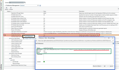

Fadel
23-Emerald I
(To:HelesicPetr)

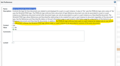

Maybe below preference causes different behavior :
Fede
HelesicPetr
(To:Fadel)
Hi @Fadel
This configuration just allow you to add any type of document as a Reference document. Also you can add reference type document to the describe by.
But it does not create new describe link to the new Document revision if you revise document separately and the document is not in the latest iteration of WTPart.
Changing the property does not change the behavior.
PetrH

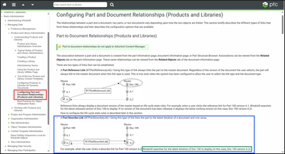

Thanks for the response and efforts. Yes, you are right. this is not OOTB functionality. I did some more research and found the WTPartDescribeLink. this property initiate link between Part and associated describe-by document.
In my case. this was set to YES, which means WTPartDescribeLink updates the Part master every time describe-by doc updated. I changed it to "NO" and it fixed the issue. This is amazing. it also gave me conceptual understanding of how part link logic is working in background.

When you mean OOTB functionality, do you mean this preference was added? I cannot find it. The image is cut off which section that preference is in.
HelesicPetr
(To:avillanueva)
Hi @avillanueva
Good point. It seams that the screen shot shows us customized preferences that are not in the OOTB Windchill system.
PetrH
KS_13883962
(To:avillanueva)
Hi Avillanueva,
OOTB (out of the box) functionality. In my case, this property "WTPartDescribeLink" was defined intentionally by CMDM. you can find windchill preferences at SITE>UTILITIES>Business Administration>Preference Management. Thanks
