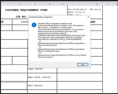

I am using Windchill PDMLink Release 11.1 and Datecode with CPS M020 CPS30
when we try to open the WTDocument primary content in excel, "windchill office integration unable to start" this error is persisting.
Here are the errors that I faced

PFA for error message
