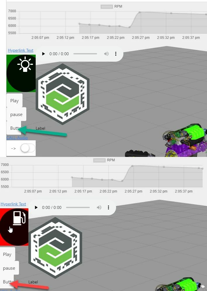

Then I  used the following code for a  definition of function which should be called from a button. The function will change the apperance of the widget Icon according to the definition of style#.css
$scope.ChalkButtonStatus=1
// call this function from button
$scope.testChalk= function()
if($scope.ChalkButtonStatus==1)
$scope.ChalkButtonStatus=2
else $scope.ChalkButtonStatus=1
 $scope.loadjscssfile("app/resources/Uploaded/style"+$scope.ChalkButtonStatus+".css", "css")
//this is utility function to load the style or javaScript
$scope.loadjscssfile= function(filename, filetype){
 if (filetype=="js"){ //if filename is a external JavaScript file
 var fileref=document.createElement('script')
 fileref.setAttribute("type","text/javascript")
 fileref.setAttribute("src", filename)
 else if (filetype=="css"){ //if filename is an external CSS file
 var fileref=document.createElement("link")
 fileref.setAttribute("rel", "stylesheet")
 fileref.setAttribute("type", "text/css")
 fileref.setAttribute("href", filename)
 if (typeof fileref!="undefined")
 document.getElementsByTagName("head")[0].appendChild(fileref)
so when we can test it in a demo project:

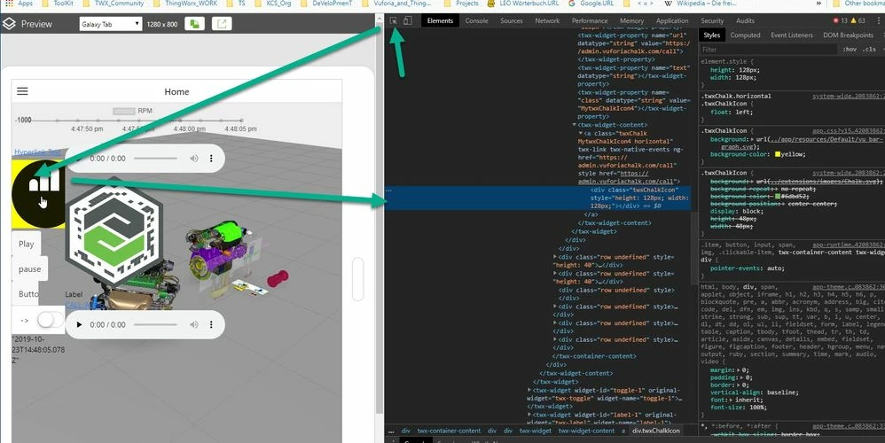

Hi @jlbrenneke ,
I check the behavior of the chalk widget and it seems that setting of  the class does not change the appearance of the chalk symbol.
Currently it read on Studio start /a Vuforia View the setting of the style named “"twxChalkIcon” and will not override it later by the class property setting. When we check  it in the debugging console in preview mode we can still see that the used class is not changed / the class property is set ok :
I will try to request  more info to PTC R&D , Thanks!
