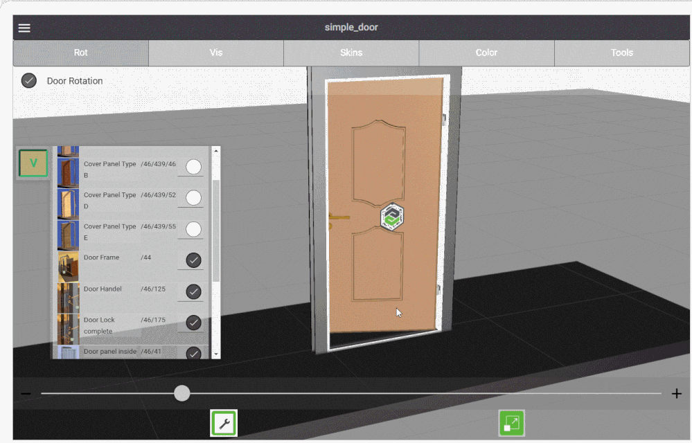

I had such solution in the project , where I transferred the database - also the info  of the model item visibility to Thingworx and did used some Thingworx services to change them and to update the display. Here example how it looks like:

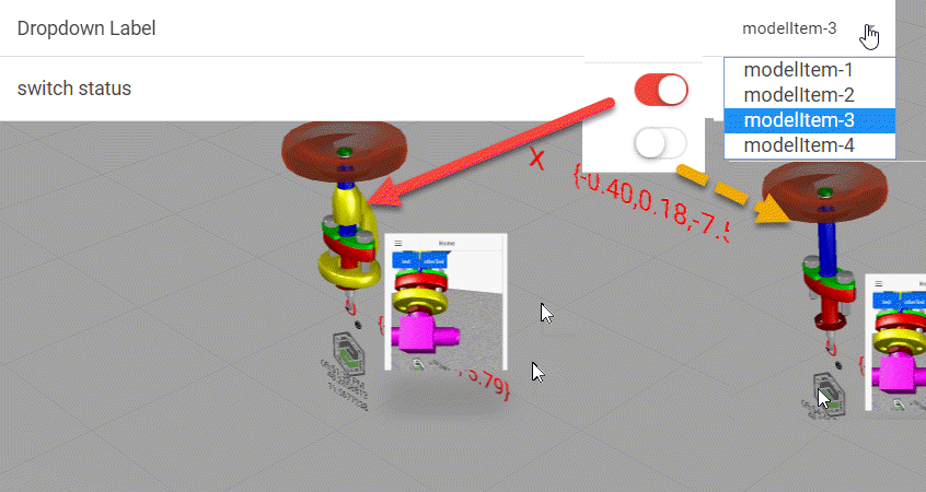

When I tested it:
It created a list of all existing modelitem widget in the current view (here the home view) and added this list to the select element ("select-1")

so now I need to be able to update the switch status ( here widget “toggle-1”) when I select in the list - so the toggle widget should display the current visibility status of the model item
and I need also a simple function to update the modelitem visibility with the toggle setting- on toggle event – which is a simple a click on it:

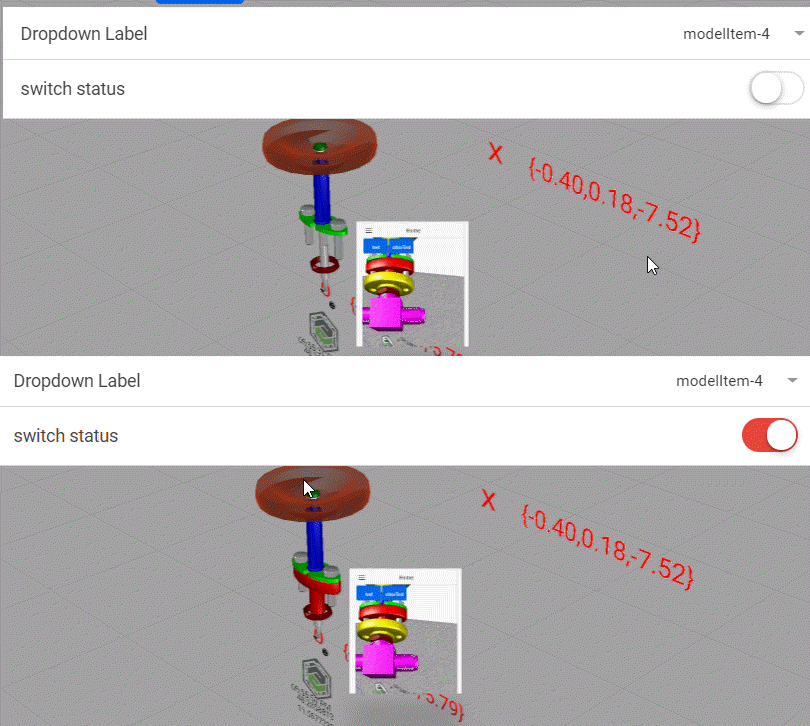

start a test in the preview mode :
