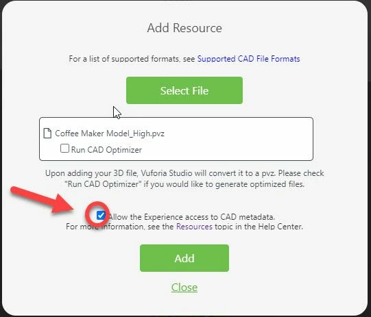

In Vuforia Studio version 8.5.13 a new metadata is intruduced. This will make the techniques described e.g. in the posts "How to extract the components with properties from a pvz file","Extracting the viewables and the seqnece steps information from a .pvz file for the usage in TWX" and "How to extract model data of 3d models in Vuforia Studio (without external Tools)?"  for the most cases not neccessarly any more. as In Vuforia Studio when a model is imported (add Resource) there is a new check button “Allow the Experience access to CAD metadata” :

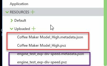

The selection of this checkbox lead that when the model is loaded to the “app/resources/Uploaded” folder but also an a json object with the name <model name>.metadata.json
Example when we load the model “Coffee Maker Model_High.pvz” then we have also a json file named “Coffee Maker Model_High.metadata.json”. This JSON file contains the metadata to the coffee maker model
The metadata json file contains some different sections for each component /

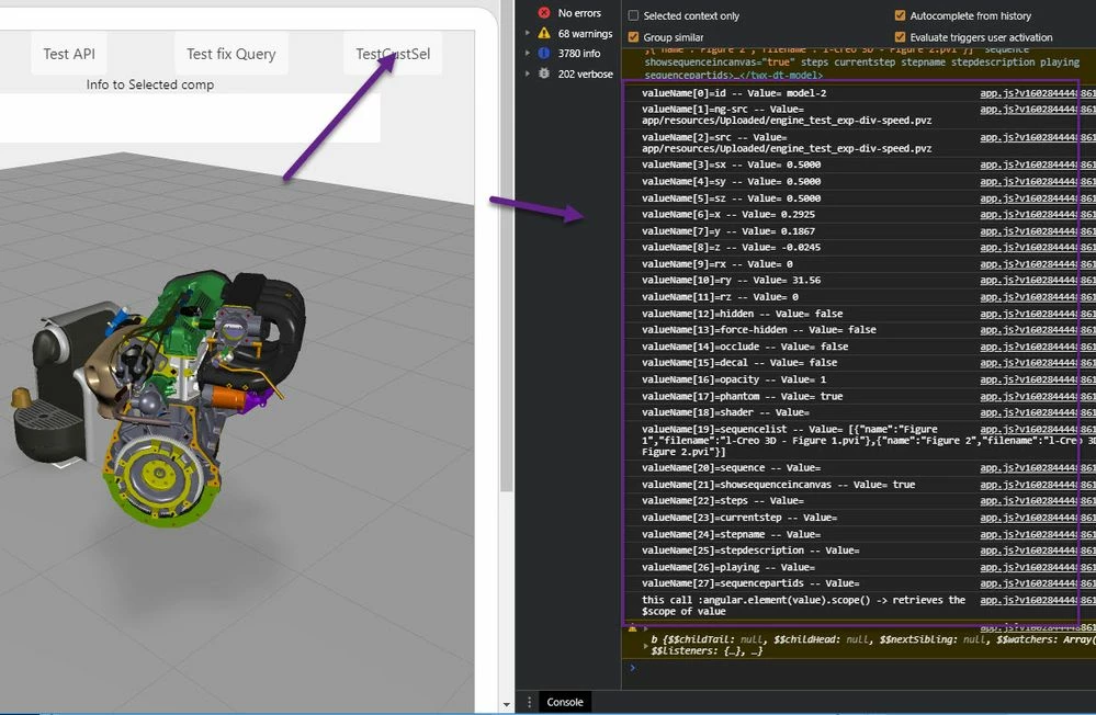

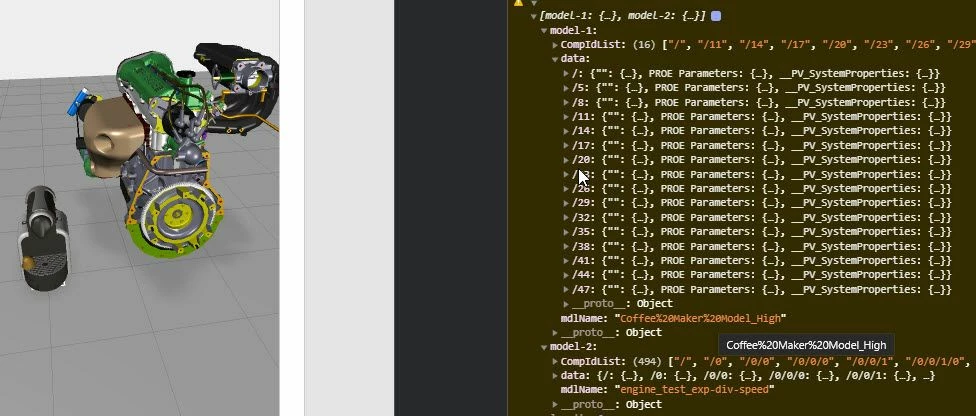

 The code listed above will load the json file to the modelWidget/s (it will works also if we have many model widngets there - and each model widget ponts to model which is imported with metadata)
When we  test this code we can check the object in memory (console.warn() ) :

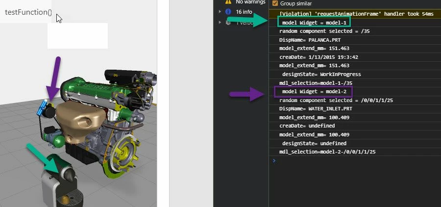

Now we can access the metadata using the normal JSON functionality - so we can   access the component data via the Comp Path Id / id paths - corresponds to the modelItem widget property occurrence:

When we test the listed code above we will have in the chrome console window:

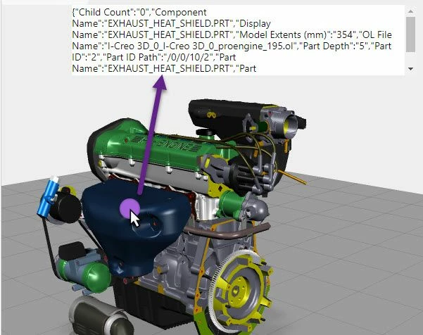

Using furhter the json  functionality we can also implement e.g. some user picks where you can associate it with the metadata :

This code will write the meta data to the selected component form the __PV_SystemPoperties section to a text area widget. Also the component will blink fwith random rgba color:
