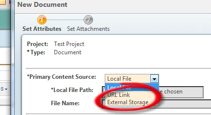

How to hide Primary Content Source options for WTDocument. - Resolved
  • November 16, 2012
  • 2 replies
  • 990 views
primaryAttachment tag has attributes *allowURL* and *allowExternal* to hide
these dropdown items in Document wizards.
codebase\WEB-INF\tags\primaryAttachmentWithMSOI.tag
Prathap <">http://goo.gl/LuT5>
