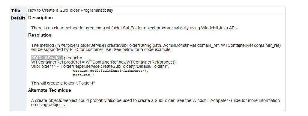

There is a way to automatically create a folder in a project ?
Someone has an example like this in case create a folder within a project
Thanks for the info that can provide me.
example: create folder in aproduct.
23-Emerald I
September 17, 2014
Ezio,
You should be able to use similar code, but instead of instantiating a PDMLinkProduct you instantiate a Project2 object:
Project2 project= <SOMETHING>;
WTContainerRef projCref = WTContainerRef.newWTContainerRef(project);
SubFolder f4 = FolderHelper.service.createSubFolder("/Default/Folder4", project.getDefaultDomainReference(), projCref);
