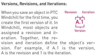

If an object has version A.1, it means that A is revision and 1 iteration.
Every time you make a little change (check-out and check-in operation), iteration increases of 1 (so first iteration is 2)
When you make a big change you do a revise (from A to B).

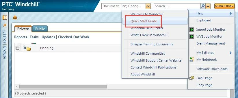

Here is the latest & greatest from PTC - the last page of the Quick Start Guide for Windchill 10.2 M020.
[cid:image001.png@01CFD232.504CEC50]
[cid:image002.jpg@01CFD232.504CEC50]
