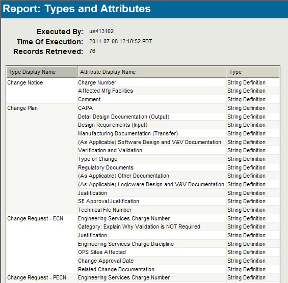

Is there a way to get a listing the attributes assigned to the Workgroup Manager CAD Document sub type of EPM Document?
I have a large list and I want to document it.

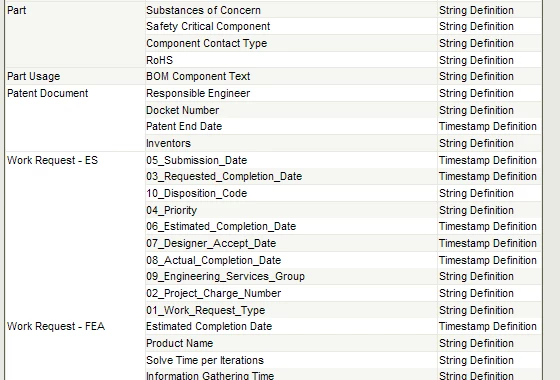

Query Builder report (attached).
Over time, we've laboriously found ways to create reports for pretty much everything that you can configure in the system. This "inventory" of query builder reports continues to grow in value and importance.
Typical result (select merging):
[cid:image001.png@01CC3D69.CD0FB1C0]
[cid:image002.png@01CC3D69.CD0FB1C0]
