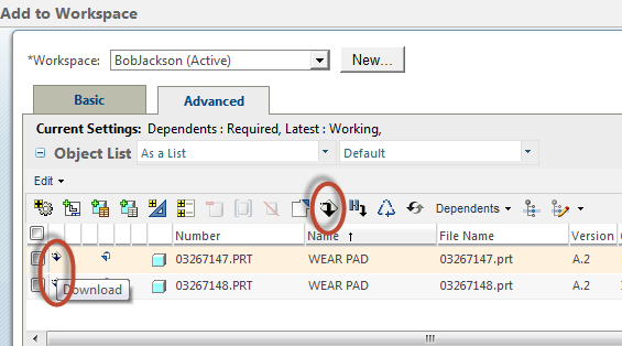

Rahul,
What if you select the objects in the workspace and select Add to Workspace? In the Add to Workspace window make sure that you use the Download option rather than Reuse so that the files already existing in commonspace will overwrite what's in your workspace.
