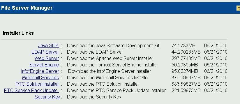

Hi Gerry, in my experience you HAVE to use the ServicePack that is downloaded from the master server. If I were you I would remove the existing replica install and start over using nothing but the files downloaded from the Master Server. I can almost guarantee this is what you are running into. I'm not sure about the ServicePack not showing any sort of "update" feature when you run it. You need to follow the guide on how to install the ccsDsu.zip file. I've attached the instructions on how to apply the Service Pack from the master server (CcsDsu.zip) file from the guide as well as the manual instructions for getting it to update as many times using the Auto-Update feature outlined in the guide fails. I just ran this operation on your exact build code with no issues so there are no bugs that I'm aware of (their used to be in M020).
Here is the outline:
1- Remove existing replica installation
2- Download all files from master site (see screenshot below)
3- Install Replica (no service pack installed)
4- Install ServicePack (CcsDsu.zip) - use the instruction set below (I'd just use the manual method at the bottom)
[cid:image001.png@01CB235E.FC014230]
