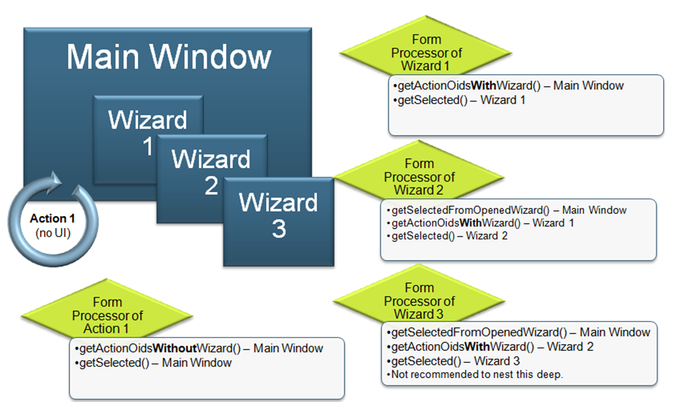

HI.
I set for my table setRowBasedObjectHandle(true)
But in FormProcessor.doOperation(...) method ObjectBean.getObject() returns null.
What should i do to get not null data from wizrd table?
Thanks.

In doOperation()
ArrayList oidList = commandBean.getSelectedOidForPopup();
June 19, 2014
You can get selected objects like a string from request:
request.getParameter("selectedOids");
June 19, 2014
you can use
commandBean.getSelectedOidxxxx(); depending upon the page from where you are calling in a wizard
see the following link in your dev box
http://localhost/Windchill-WHC/index.jspx?id=WCCG_UICust_ConstructWizards_WizardProcess&action=show
There is a diagram to explain

But if I want to get selected objects in the class that extends TreeDataBuilderAsync (not xxxFormProcessor). Is it possible?
June 20, 2014
Just try this
in the buildComponentData
NmHelperBean localNmHelperBean = ((JcaComponentParams) params).getHelperBean();
NmCommandBean nmCommandBean = localNmHelperBean.getNmCommandBean();
getHelperBean();
From the nmCommandBean, you should be able to get the request/form data
Sorry for the format. When I cut and paste from eclipse, it is behaving like this
