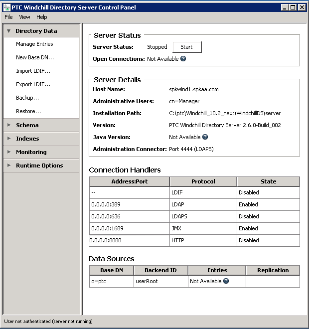

Ok, I was here a few weeks ago with a problem with Windchill 10.2, and how it couldn't get it properly installed. I managed to get through that, get it installed and get it up and working.
Today, I went back to the Windchill server I built and noticed that it was not running. So I went through my startup process to get it running, and I noticed that for some reason my HTTP server will not start up with the rest of Windchill. The directory server Control Panel states that HTTP is Disabled.
I have no idea what happened to this or why it isn't now working. I've skimmed though various log files and error files, but I haven't seen anything that looks like an error.
Any assistance would be greatly appreciated.
Steve

Okay, I found another thread that pretty much described my problem to a "T". The answer there was to run the following command:
"ant -f config.xml installService" from the <Windchill root folder>\HTTPServer
the first time I got "ant" is not recognized as an internal or external command....
Figuring this was a path problem I executed the following command:
<Windchill root folder>\Windchill\ant\bin\ant -f config.xml installService from the same directory as above
The script started off with an error "Unable to locate tools.jar. Expected to find it in C:\Program File\Java\jre7\lib\tools.jar
but other than that the script seemed to run to a successful conclusion:
BUILD SUCCESSFUL
Total time: 6 seconds
Unfortunately, that didn't seem to solve my problem. It didn't start up the HTTP server, and when I tried restarting the Windchill directory Server via the Control Panel, the HTTP server still did not come up.
Any advice would be greatly appreciated.
September 5, 2014
Are you running these commands from a windchill shell? You should have them in the path. I have <Windchill>/bin; <Windchill>/ant/bin; <JAVA_HOME>/jre/bin; <JAVA_HOME>/bin; at the start of the path in a windchill shell. In my wt.properties I have "wt.env.JAVA_HOME=$(wt.jdk)" and "wt.jdk=<my java install dir>"
