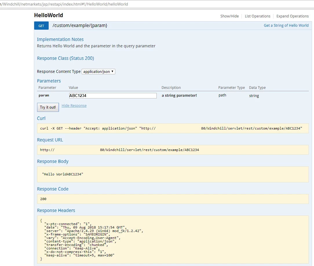

I've made some custom REST APIs on top of the existing swagger APIs @ <environment>/Windchill/netmarkets/jsp/restapi/index.html
I'm not sure if they are specific to FlexPLM or not, in which it might not work for what you're looking for.
I'll make a quick Hello World tutorial for you. I'm planning on making a little more in-depth tutorial later on my website but this should get you something to play around with.
We'll be modifying the rest.properties file @ WT_HOME/codebase/com/ptc/windchill/rest/rest.properties using this xconfmanager command from WT_HOME in a Windchill Shell:
xconfmanager --add type.rest.resources=com.custom.rest.HelloWorldService-t codebase/com/ptc/windchill/rest/rest.properties -p
or you can add it as a property in the $WT_HOME\codebase\com\lcs\xconfs\flexplm.rest.properties.xconf file.
As you probably guessed it you'll need to deploy your class file to the codebase/com/custom/rest/ directory after you finish compiling it.

That's just a simple GET operation, but we've been successful in PUT/POST operations as well. I'm currently working on a document/image page upload API at the moment.
I'm attaching a screenshot of the output of this demo.
Hope this helps and I didn't misunderstand your request.
