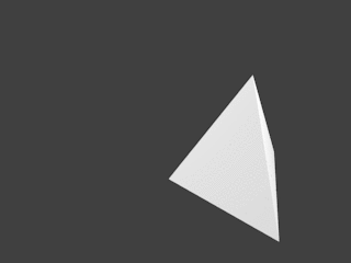

For a better performance and calcualtion of the face normals the inner faces of the mesh have to be removed. Ok, not a big deal, since it was a FEM grid, every element has its own boundary faces and if a face in the global mesh exists twice, i can just remove both of them. But there is one problem: There are some h-elements missing. More precisely, h-elements, that do not share a boundary face with their p-element, are missing. (missing_elements.gif)
Do i misunderstand the way the .neu file describes the mesh? Does someone here has experiences with the Mechanica result files?
