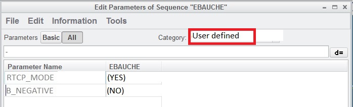

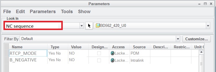

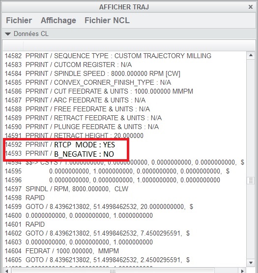

It would be great to be able to add customized step parametrers in order to ouput in the NCL and use them with the post-processor.
- this could be added in a manufcuring template like:
- These parameters should be avaible for all the steps

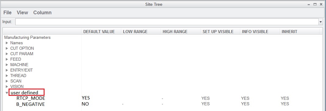

- the display and default value could be set in the site (generic, mill, turn, holemaking or WEDM)

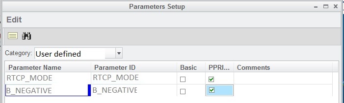

- the ouput to the ncl, could be set thru the Parameters UI
This would avoid creating relations for each step or fdu
