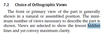

June 3, 2014
hope this helps..
ASME Y14.3
-- describe shape as in Sheetmetal parts
