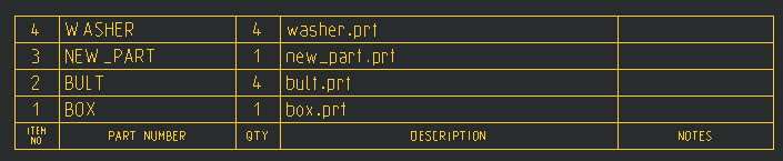

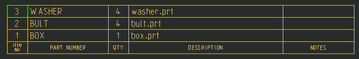

Is there a way to controle which way a BOM-table sorts its members? When I have an assembly and create a BOM-table it looks like this:
When I add a part (NEW_PART) this is placed in alphabetical order recieving the number 3. This changes the number for Washer to 4.
I wish to have the newly added part last in the BOM-table so that the other parts keep their original number. Is this possible?
Is it possible to arrange the BOM table after the order the items appear in the model tree instead of in alphabetical order?
