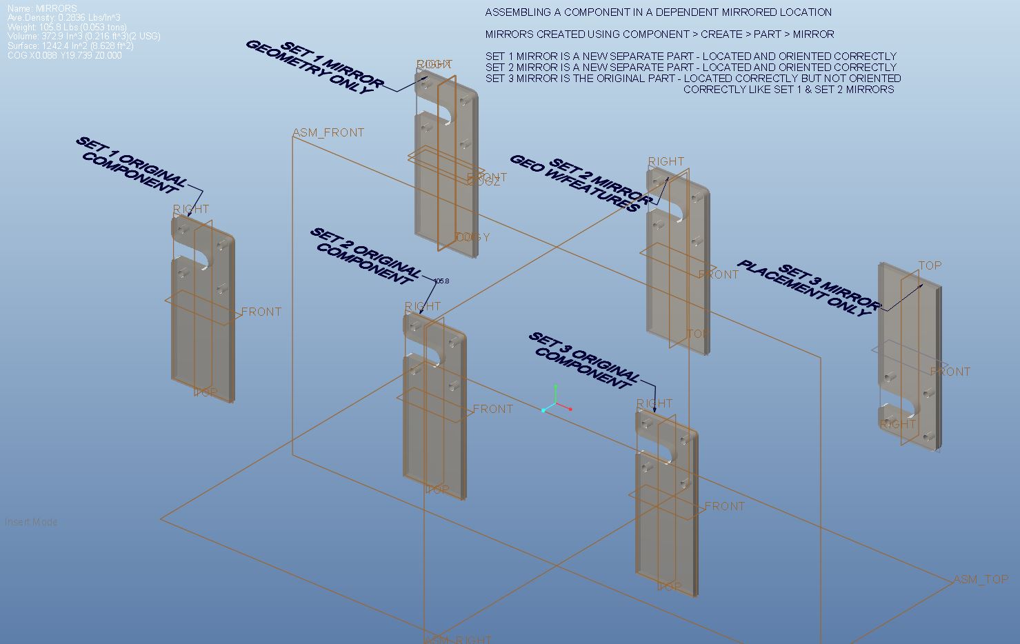

In almost 20 years of using PTC 3D modeling, while there have been extraordinary gains in capabilities and productivity, there are some limitations I have always had to live with. In this case, maybe some discussion will shed some new light.
All I want to do is to use the same part in an assembly - in mirror dependent locations - without having to create mirrored references or write relationships. Seems simple enough - maybe place a bearing mounting plate on both sides of a symmetrical conveyer for example. Does anyone else out there run into this simple scenario? Personally I strive to use the same part in as many assembly locations as I can - just seems more efficient that way - even though it does require some thought into the symmetry of the part.
Its real easy to do if you can live with having a new part created - but that just complicates the BOM - and the shop is asking 'why did we just have two separate work orders for the same part?'.
First of all, you might think, intuitively, that assembling the same part in a mirror location to an existing part might be an 'Assembly' operation. But no, you have to go through the 'Component Create' interface. Of the 'Mirror types', selecting the 3rd option 'Mirror placement only' will ignore the part name in the previous Component Create window (this is more information than you will find in the Help Center).
The following Image shows the results of each Mirror part 'type'. Both 'mirror geometry' options create the correctly located and oriented part - that also adds another part to a previously simpler BOM. The third option 'Mirror placement only' part is just not oriented correctly - and is totally useless to me. Does anyone else see a problem with this? (Click on the image to enlarge it.)
And yes - this 'placement' can be accomplished with a "Pattern" - but it usually requires a relation or additional references to be truly 'location dependant'.
I have submitted this to PTC and got the response that it "Works to Product Specification". I'd hate to think what would happen to existing model assemblies if a change was made to the current default orientation of any part placed in this way. What I think needs to happen is the addition of an option to control the orientation of the Mirror Placement dependent part - something dynamic on the screen that shows you how it's going to end up oriented.

Hello Aaron,
You mention an old known functional gap, that can be defined as "mirror assembly and reuse symmetrical parts, smartly locating them in mirrored assembly". I have no legal to commit, but this is on a to-do list for our next version to come (not the one in current development, unfortunately).
We do have an old option to say "Reuse" for some components while in Assembly Mirror UI (or if you just mirror one part - option "mirror placement only"). What it does it simply "mirrors" part origin vs. the plane and sticks reused part by its origin to that mirrored CSYS. Now : when CSYS is mirrored we have to flip one of its axis to stay in Cartesian system (right handed CSYS) - and Creo steadely will flip Z direction if I remember it correctly.
Now knowing this you can design your symmetrical parts in a way that will work just fine for such Mirror / Reuse : design a part symmetrical vs. X-Y plane, try Mirroring it - see what happens. In particular for bearing which has 3 planes of symmetry it will be enough to model it when midpoint of the bearing coincides with model origin.
This might be not relevant proposal if you already have designed parts or imported parts that have their origin far from symmetry plane ...
Let me know if you try this and it works
Best,
- Vlad

You can mirror a part that is not a new component using Create. It is the terminology that PTC uses and that you have to give a "new name" that cause confusion. Aaron is having difficulty with some quirks about the way Creo is mirroring the components. I haven't experimented with Aaron's scenarios and can't comment on them.
To create a simple mirror placement of a component in an assembly, in the Model tab, select Create then in the next box, select Part and Mirror (give a name for the part that will not be used but is unfortunately the confusing part), then select OK. In the next box, select MIRROR PLACEMENT ONLY (this is how Creo knows you don't want a new component even though it made you give a "new" name) and then select the component to be mirrored and the mirror plan reference.
This method is NOT creating a new component and your BOM will be accurate.
