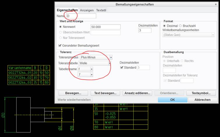

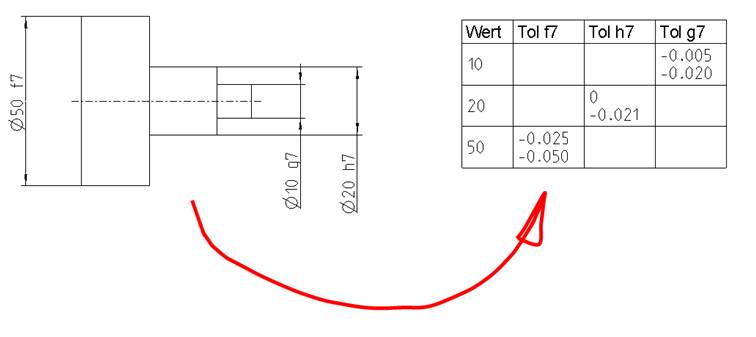

Question 1.)
Colleagues from the equipment design have the wish to insert intelligent tolerance table to the drawing  Does that mean , it was a prt generated and in the drawing dimensioned both with the body measurements as and with the tolerances. Now the colleagues want to insert a table that automatically detects the prt what tolerances ( fits) are available and inserts them in a table.
Is this possible?

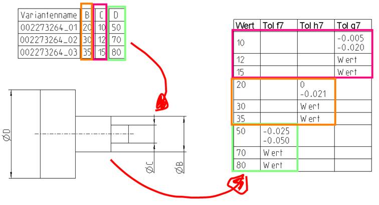

Question 2.)
The increase is a family table . Here is indeed worked with "symbols" like B , C or D and not with the visual dimension. So you have absolutely no relation to any fits for the controlled dimensions.
Have you any idea whether something can control anyway? Or is there something in some way already exists?
With the normal Creo boardtools we cannot find any kind of solution. Creo and PTC is here quite limited or we find it not.
It must also not look like this , this should merely serve as an example.
