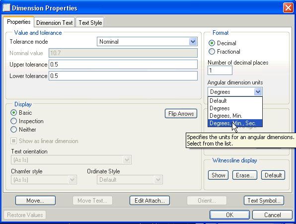

So we have switched from using decimals degrees to using degree-minutes-seconds. Seems like a relatively easy switch.
I change the config setting for ang_units to ang_sec. It works fine, BUT...there's always a big but around somewhere.
I'm trying to show 23±0.5 degrees as a limit dimension. So, I get [cid:image001.jpg@01CB4B52.D5B37320] when I have the decimal set to 1 place, but I don't want the trailing zero, so i set the decimal to zero and get[cid:image005.jpg@01CB4B52.D5B37320]. I can't seem to get it to show 30 minutes without having 1 decimal place.
Okay, so I understand that 1 decimal place is required for .5 degrees, but come on, I can't exchange decimal degrees for decimal minutes.
Anyone have the amazing solution to my problem or am I out of luck because I asked on a friday before a long weekend holiday.

You've gotta pick this
to get this

StephenW23-Emerald IIIAuthor
September 3, 2010
Except now I get the trailing seconds and I don't think that will fly either.
[cid:image001.jpg@01CB4B54.D3A0ADD0]
September 3, 2010
Thanks Wayne, that was what I had missed.
September 3, 2010
Okay, so in summary, between Bob and Wayne there was an "easy" fix.
For completeness, here is everything (I think) I changed to get from decimal degrees to degrees-minutes-seconds...
In the CONFIG.PRO I added ANG_UNITS ANG_SEC.
In the drawing setup file, I set the following:
draw_ang_unit_trail_zeros no
In the drawing, I edited the properties of the dimension and set it to DEGREES,MIN,SEC
I think that is all I did to make the switch for this draiwng.
Thanks again for the quick responses,
Steve
