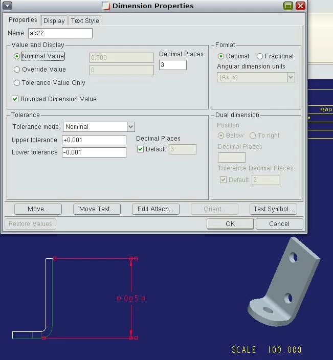

OK, here's a new one for me. Suddenly I cannot change the decimal places in my drawing. This is WF5. See attached:
screenshot
After I click OK, it still views as "0.5". Another strange thing, The scaling is incorrect. This is a "B" size drawing, with the part .500 high at a scale of 100.00, the view should be 50 inches in height, why does it fit. I had to do this because when I inserted the view it was just a pin dot. I tried re-creating the drawing under a new name, but the same thing. Maybe I should try recreating the model.
Anybody have any ideas where else I should look?

OK, it was quick. The culprit, I created a new drawing template. The drawing units were set to "mm". Strange, I never use "mm" and it wasn't the default "inches". I set the units to inches, my drawing view then became monstrous, and I reduced the scale to 5.000. Now when I create a dimension it's 3 decimal places. It ends up the two issues I was having were related.
Thanks all for your quick help.
Paul
October 7, 2010
Mr. Paul Gress,
Did you SHOW that dimension? Or did you CREATE that dimension? IF that
dimension is coming from the MODEL it should be rather easy to change the
number of decimal places.
I noted that this is a "ad22." That tells me that this is an ADDED
DIMENSION. You need to check your drawing settings. There is something that
is overriding the dimension places.
The other thing I would SERIOUSLY consider is SHOWING the MODEL DIMENSIONS
instead of adding them. Why would you want to waste time adding dimensions
when you can get them from the sketcher?

This maybe weird, but if the .5 was actually mm scaled 100 times, this
would make the part appear approx 2" tall on the drawing.
Secondly, showing model dimensions may not always work in all scenarios.
Design intent dims may not always work well for manufacturing.

The following config option sets the number of decimal places shown with a created dimension.
sketcher_dec_places "number"

this is not a setting in Creo 2.0, it has the the red circleand the line thru?
