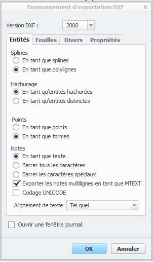

I often export dxf for our punching machine and also for a milling machine using the settings below.
And in my config.pro :

Tried changing the settings but no avail, can reopen the dxf in PTC Creo but still can't get it open in RDWorks or Adobe Illustrator (have to convert to CGM for Illustrator).
Strange as it's worked in the past and I don't think I've changed any settings in particular.

I too was able to open the DXF file in Creo but it failed in AutoCAD. I typically use 2004 output and haven't had any problems.
Would an IGES output work for you?

So have found a work around that suits me for now after countless trys getting the dxfs to export properly.
Workflow now:
1) Export to IGES.
2) Open with FreeCAD.
3) Save as DXF.
Whilst it doesn't appear to be the quickest route it does allow me to do it all from my machine pretty quickly without wasting other designers time converting files.
