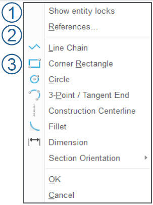

  1. Show Entity Locks – Toggles the display of sketch entity locks that were used in place of dimension locks.
  2. References – Provides a shortcut to the Sketch References dialog.
  3. Shapes shortcuts – Quick access to sketch tools such as Lines, Rectangles, Circles, etc.

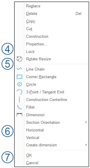

    4. Lock – Locks sketcher entities in leu of locking individual
        dimensions.
    5. Rotate Resize – Activates the Rotate/Resize command.
    6. Constraints (Tangent, Coincident, Equal, etc.) – creates various
        constraints based on current selection of single or multiple sketch
        entities.
    7. OK/Cancel – Allows quick completion of sketch feature.

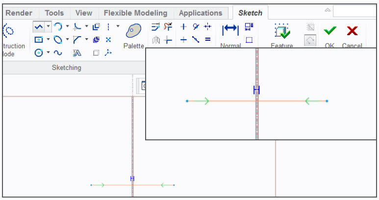

  1. When symmetry is desired, create Centerline features first, allowing Creo to give symmetry assumptions while sketching.

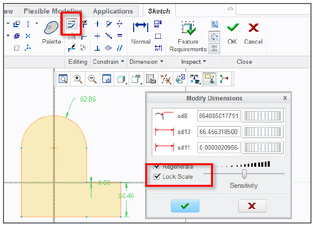

  2. Use Modify along with Lock Scale to resize sketches that are grossly out of proportion.
