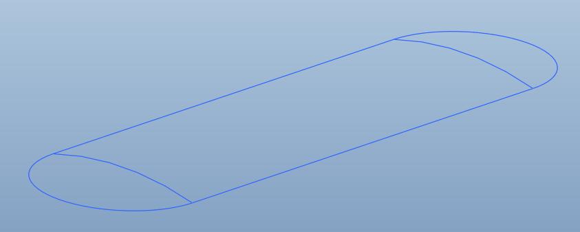

We are trying to create a surface that fills in a sketch and uses 2 curves to create a domed top. Can anyone tell me how to do it?
Here is a quick sketch of what we are trying to create. The 2 cross sketchs are raised.
I have attached a model of this skeleton. I also attached a STEP file of what we are trying to end up with.

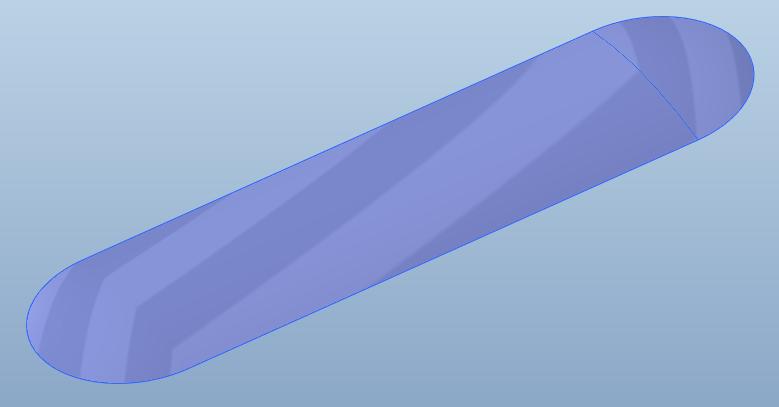

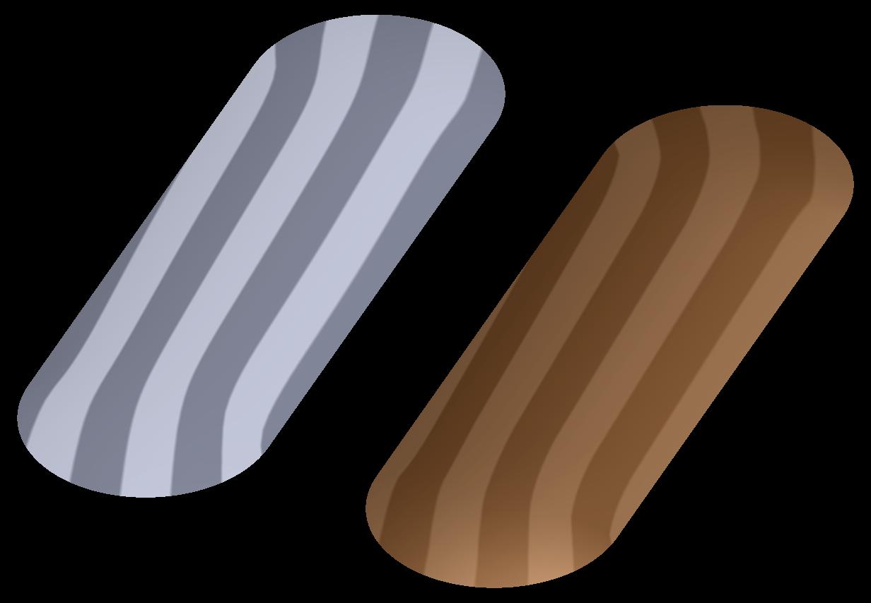

Ok, here's the latest and last stab at it. The surface is made with a VSS and with the exception of the spine, all the trajectory curves are conics with the rho vale for a perfect 90deg arc (use the sketcher section relation: rho = sqrt(2) - 1). If I used conics in the section of the VSS, it gave some funny artifacts at the curved edge, so the section was an arc driven by the 3 spines. I think this is a LITTLE better, but I think this is also the practical limit to Pro/E without the ISDX package. The grey surface is Pauls first STEP file, the bronze one is my latest. Have fun!

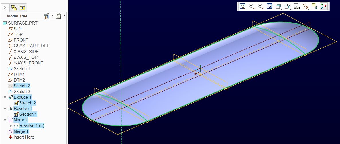

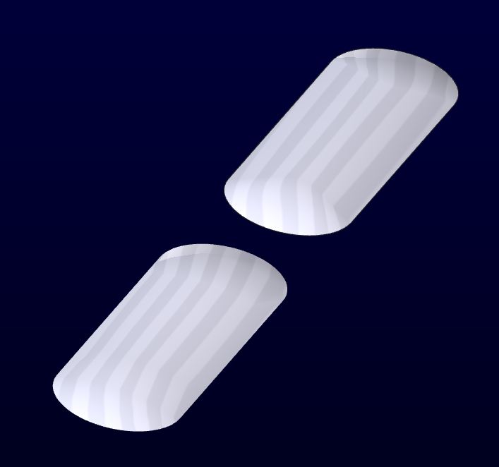

Very simple:
Extrude the arc on the right up to the arc on the left. Next, revolve 1/2 of the arc by creating a new sketch on the lft vertical plane, 180 degrees. Next, mirror that new endcap to the right side using the center plane. Next, select the center bit, and the the two ends (with CTRL) and click "merge"
February 27, 2013
...attached is Creo 2.0
pwyndham1-VisitorAuthor
February 27, 2013
I tried that route but it creates a tangency at the points where the revolve meets the central extrude.

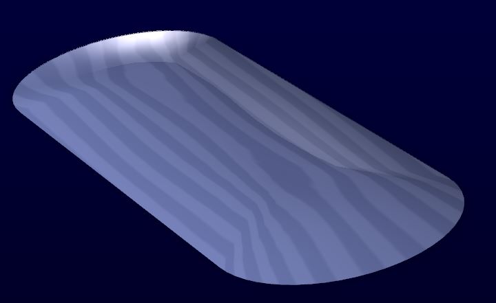

Here are some screenshots showing the reflection lines on the revolves compared to the STEP file.
Notice the much smoother reflection lines on the grey part below.
Industrial Design is requiring us to not have the tangency.

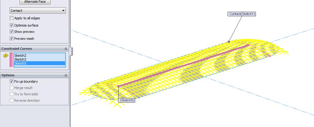

In theory the center section would go straight across and not have the two humps in it. We originally thought we had it licked with the extrude/revolve trick, but the ID guy is stuck on the C2 idea for the top surface.
Getting the center flat can be done in SW by adding a 4th sketch between the two guide curves.
Attached are a copy of the SW file I am messing with and a step created from the SW file.

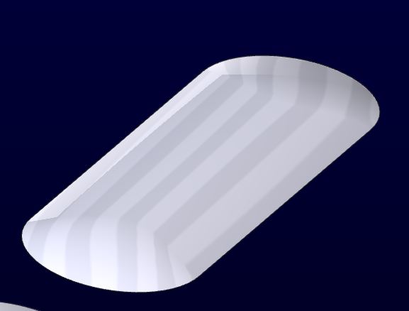

February 27, 2013
The "humps" are doing a lot for softening the transitions.

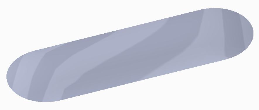

From a logical standpoint, I used the original profile to closely mimic the larger radius of the vertical section and came up with something that looked like this for surface transitions.
...which translates to this with the analysis:
which compares to the original step as:
I don't have the style module so I cannot go into this further. The tweak feature might give you something completely different.

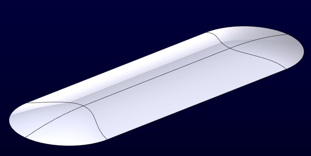

Without what used to be called the ISDX surfacing module you can't really get C2 curvature. You can attempt it, but not quite get there. I'd tell your ID guy it's close enough unless he feels like doing it. The style guys want this and that, but unless you're doing high-speed airflow, or it's a reflector for a light, or it's the sheetmetal for a car, it's not reallya big hairy issue, he's just being too picky and Pro/E doesn't have the tools to 100% do it without that module. It's not the "tangency" that's the issue, it's that it's not C2 continuous curvature.
Here's a model I did with a couple different types of surfacing on it for ya.
Also.....why not just import the surfae where you want it, and do a solidify to add it to whatever solid geometry you have?

The Boundary Blend is probably the closest one can get without the Style extension. Notice that the command does have curvature options.
The attached was created with similar thoughts as the previous posts. When I tried to mirror only half the boundary blend, it had a really bad edge. Making the entire form in one go helped a lot.
You will find an ellipse in the flange face (for edge tangency) and you will find the "domes" controlled by a spline with an arc as a control feature. I am sure further refinement could be done with more boundary influence curves.

I thought the VSS option was kind of interesting. Now I'm wondering if maybe using a conic section instead of an arc will smooth things out. Gonna try that.
I did the boundary blend with the curvature option (vs the tangency option if I remember) in the part I posted, and that still had the line that's so objectionable to the ID guy. I think in some instances a VSS gives you some options that the blend doesn't, and vice versa. I think the VSS opteion smoothed the transition out near the ends, but was obviously flattened (I emphasized it) in the middle. Although, I like that surface from a "styling" standpoint better than the ID guys! Looks cooler.
