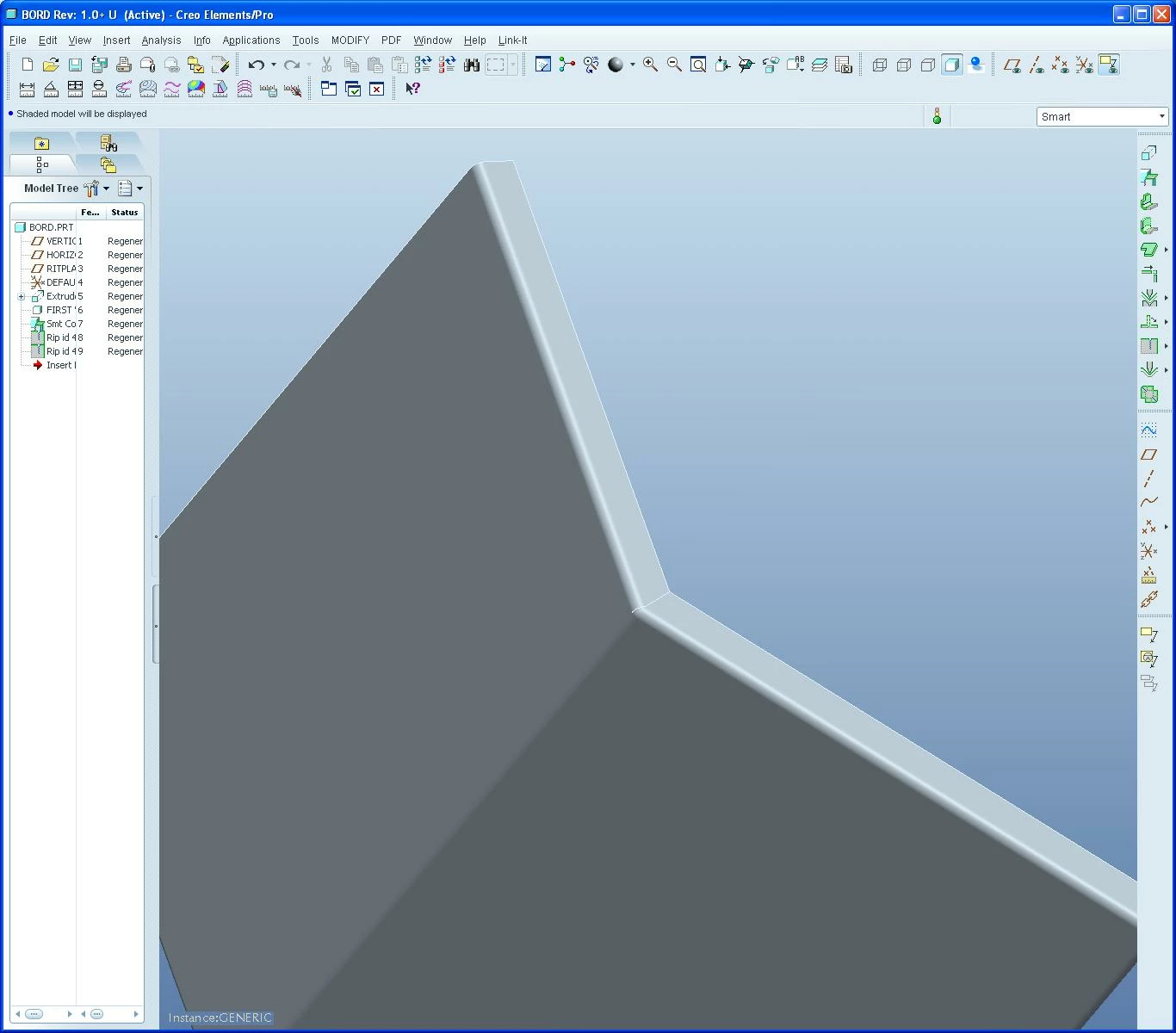

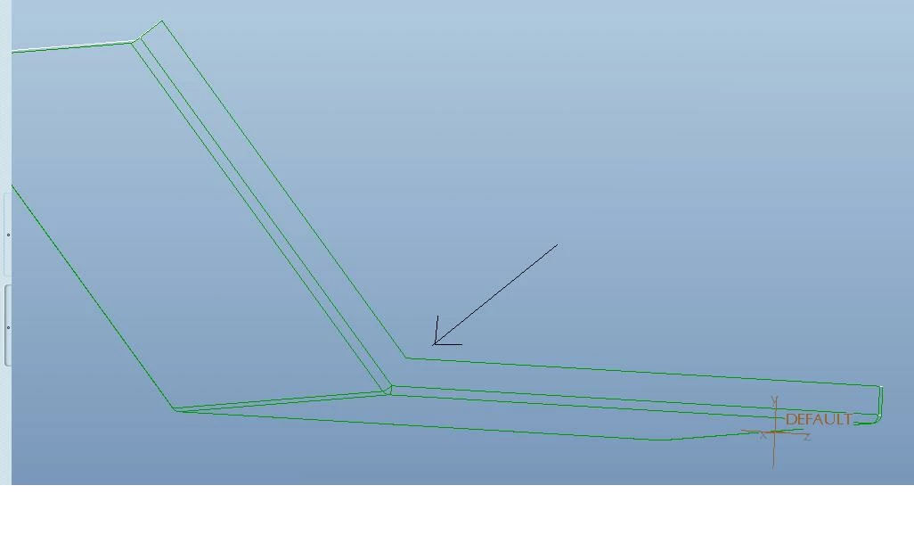

I need help with doing a rip in my part. I made the part in "standard" mode and then converted to sheet metal (shell).
But now I need to do a rip to create a flat state but I don´t know how to do.

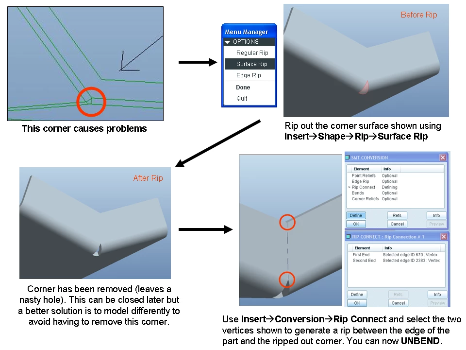

The best way to create the rip you want using the model "as is", would be to use a SURFACE RIP along with a CONVERSION feature. The corner surface (circled in the attached graphic) is your big problem. Were it not for this piece, your rip would be a piece of cake.
In Sheet Metal Mode, go to Insert>Shape>Rip>Surface Rip and choose the trianglular corner surface to remove You can do more than one rip if there are other odd corners to modify. This is not a very pretty rip because the larger your bends, the larger the missing chunk of material you'll have. However, unless you remodel the part to take advantage of other rip/unbend techniques, you're stuck with it. See the graphic attached for before/after pictures.

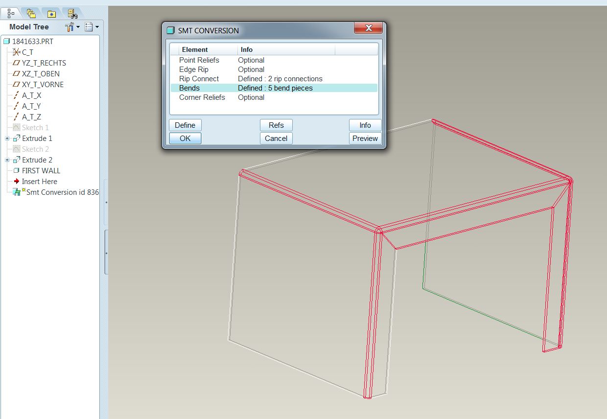

Next, select Insert>Conversion and select Rip Connect from the "SMT Conversion" menu. Choose Add and then pick two points (shown in the graphic) to define the rip. You can do multiple rips at other locations if necessary. Once you've completed the conversion feature, you should be able to unbend the part.
As I mentioned, there are probably better ways to model the part such that these corners won't present big problems. The sheet metal conversion feature is very powerful. You can use it to add BENDS to sharp corners, point and corner relief, and rips all in one feature. Check the Pro/E help files for more information. By making your initial solid model less restrictive, you can utilitze conversions to add bends and rips without having to remove large chunks of surfaces with the surface rip. This can result in much tighter joints and a better looking finished sheet metal part.

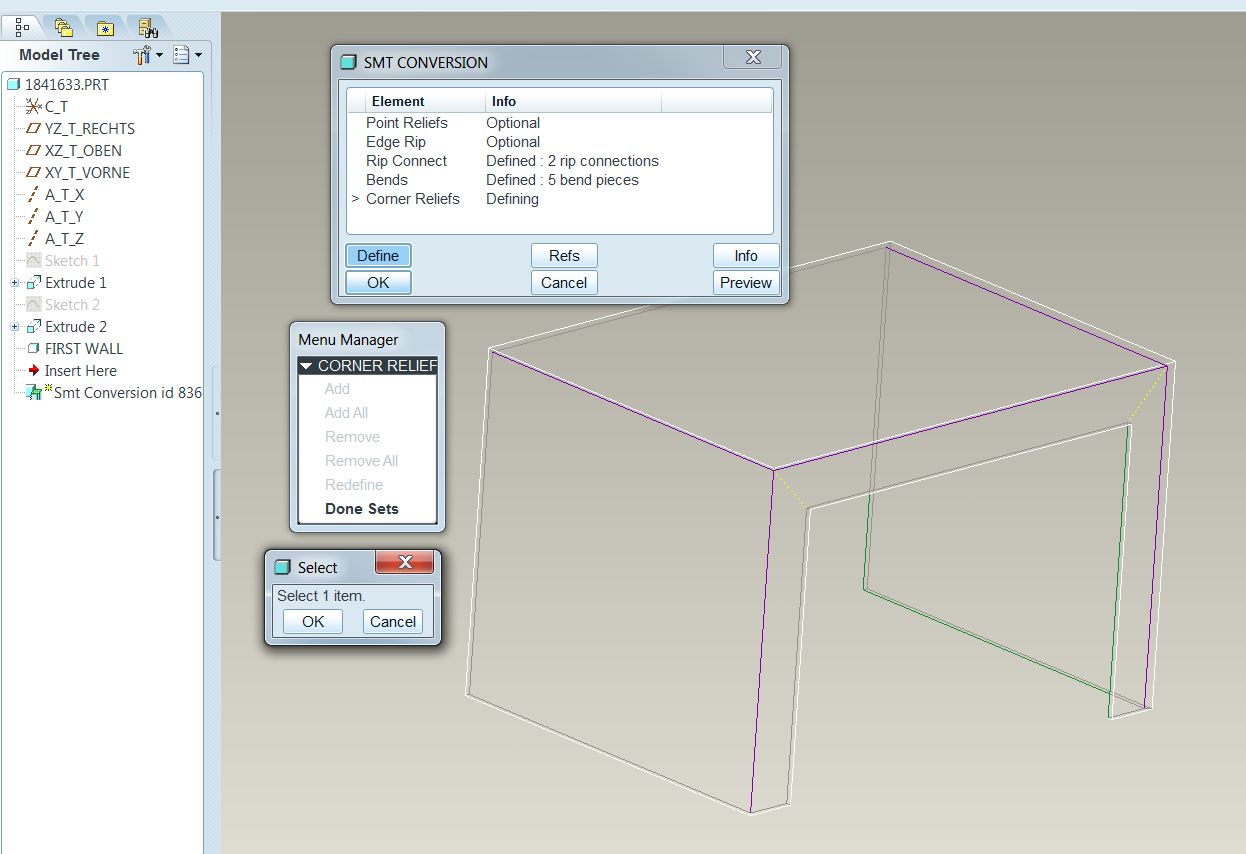

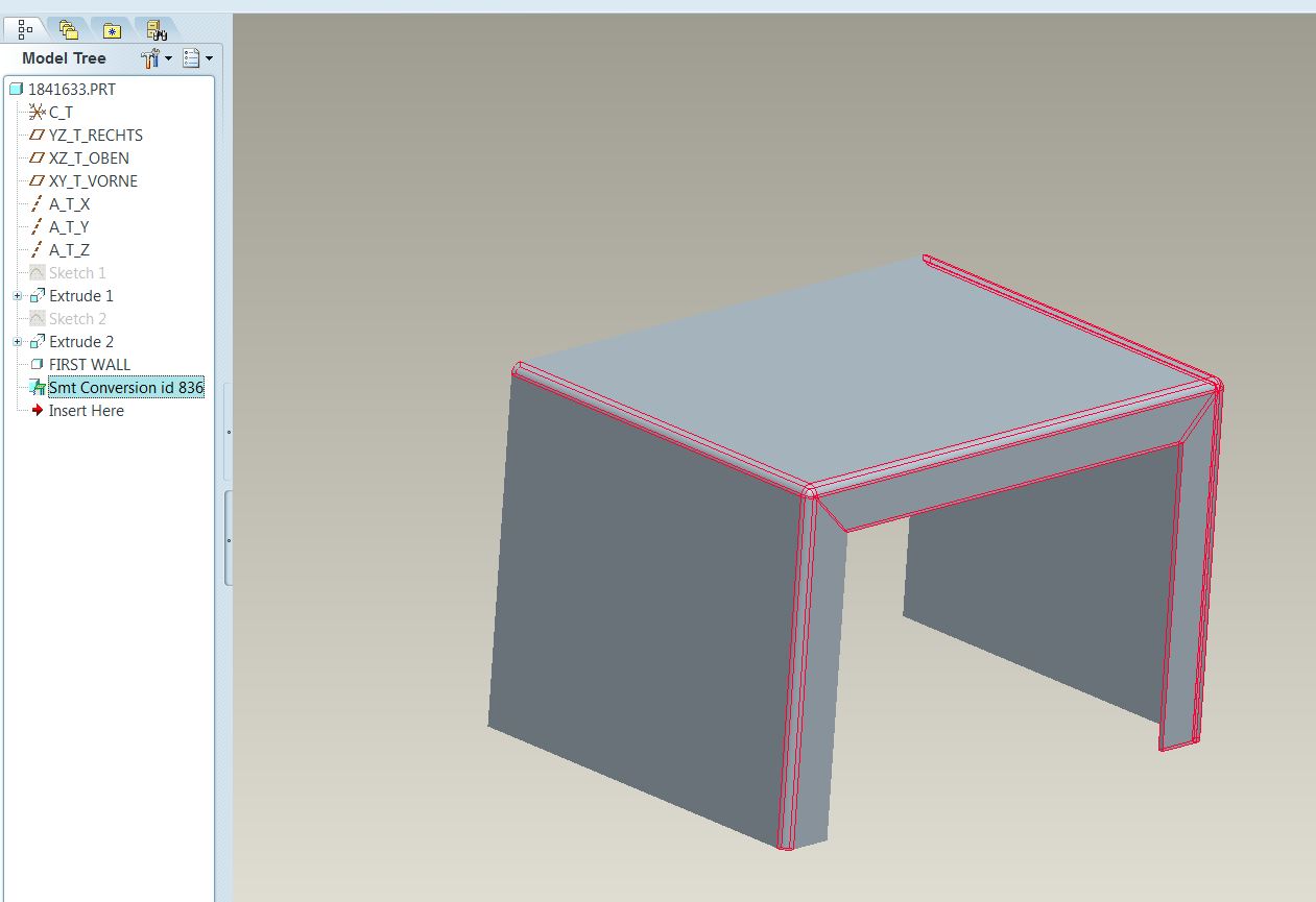

Hi to all,
Thanks for the explanations.

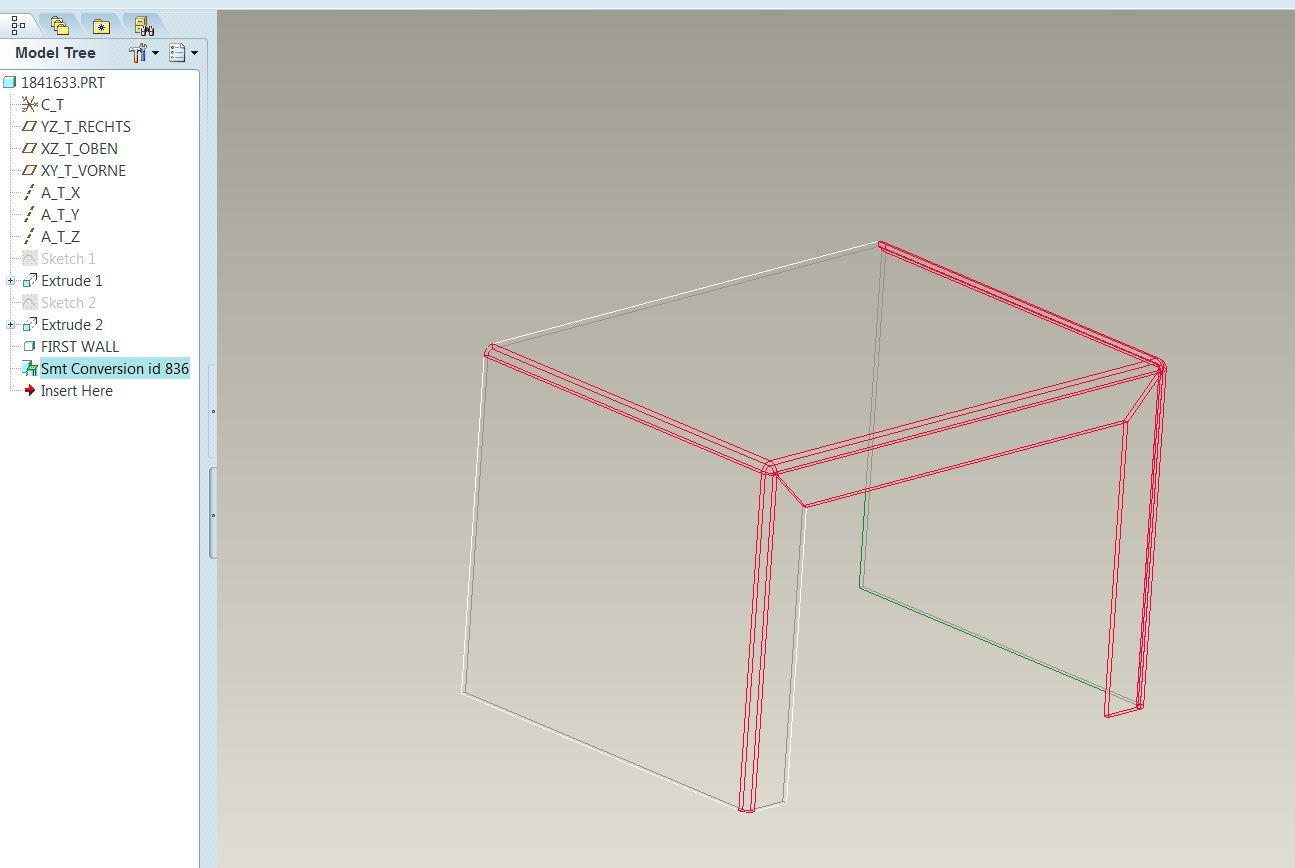

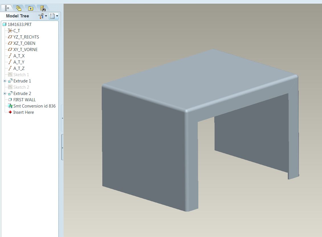

I am working on a similar sheet metal part. Through the basic sheet metal conversion menu I cannot get the part to "rip" and "corner relief" succesfully. I can get the bends and the rip connect features in (althouh it requires to first define the bends and after that, define the "rip connects"). But in the end, I cannot get any corner reliefs in. It simply will not snap on the corners, in fact, the entire "corner reliefs" menu is grayed out, so there is no selection possible...
Really need help!

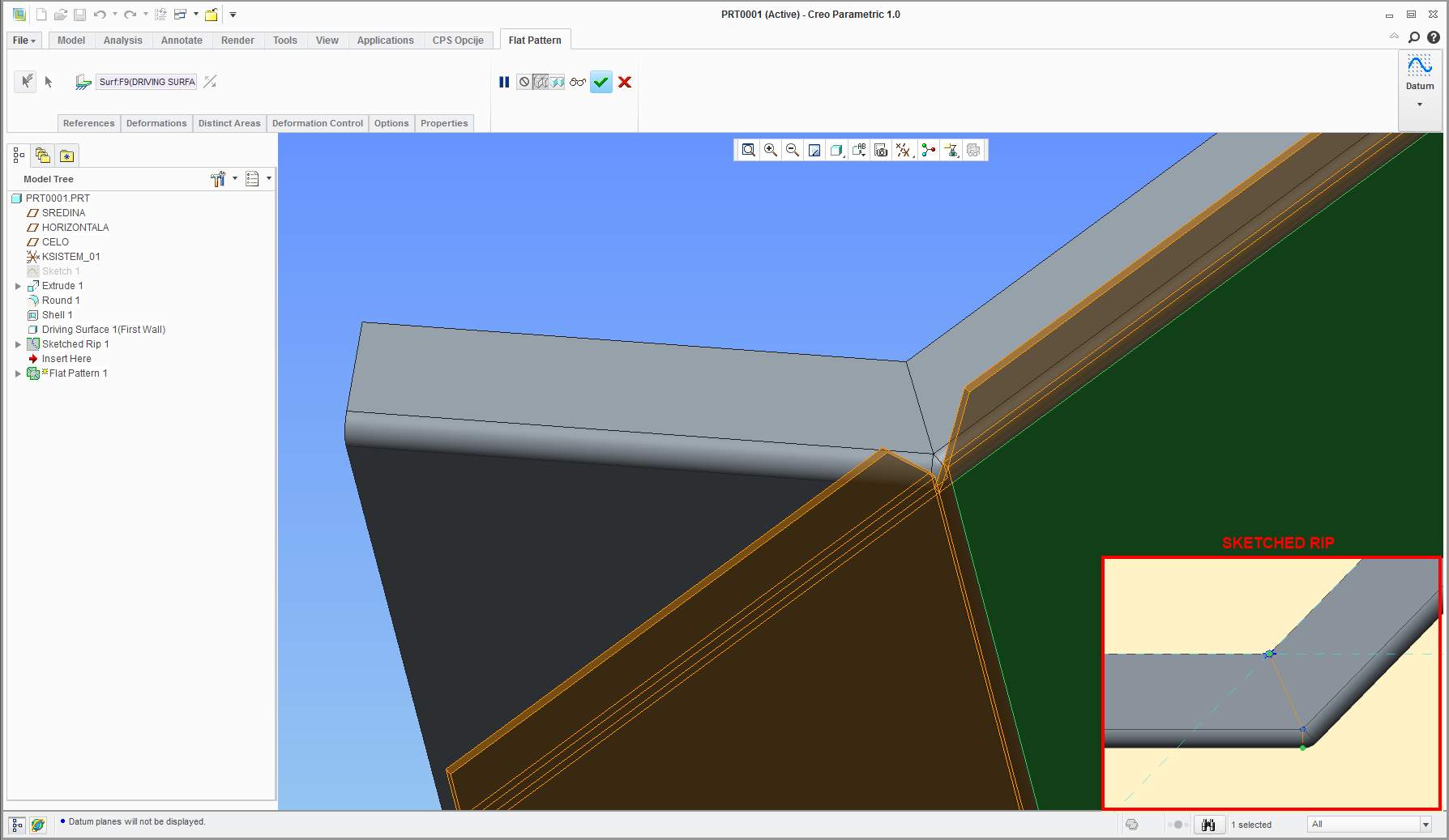

I just wana show alternative solution tho Brian`s better.
You can use sketched rip and avoid removin surface.

When I follow Brians solution I succeded with my flat pattern but when I try Davor´s solution with a sketched rip I´ve failed. I did a regular rip and sketched as he suggested but I can´t do a flat pattern.
Please help med
