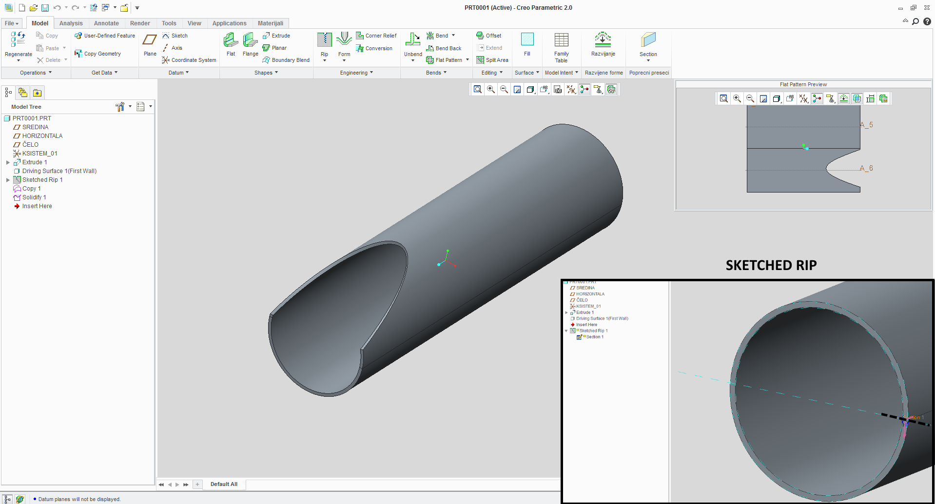

Flatten quilt can be inaccurate if you are unbending sheetmetal that is bent in 2 directions. Tho in your case better option would be to draw new pipe without cutouts then make sketched rip. Then make those cutouts. Or if its imported part copy surfaces of those cutouts into your new part with whole pipe and then use solidify to cut pipe as original.

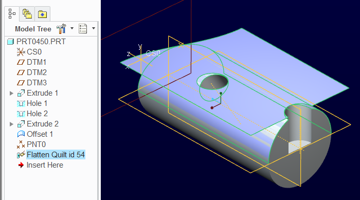

Sagar asked before how to unfold a sheetmetal pipe using no bend k-factors and match the outside surface circumference. Unwrap was one unfolding a quilt was one option...
how to unfold the pipe
Sagar, you have to create the point on the surface to help the feature define where to unfurl from. I place it on the edge, in line with the datum plane. I also only unfurled half the pipe at a time. It may be possible to do the whole pipe if you merge the surfaces but you might have to make a seem.
July 19, 2014

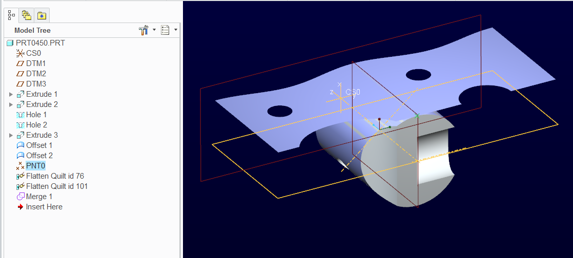

This is flatten quilt for 2 halfs and merging them at the end of the process.
Notice the datum point feature in the tree and at the intersection of the datum plane and the edge.
