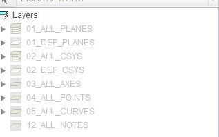

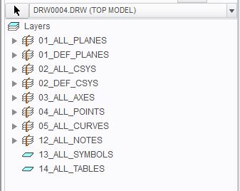

We have created drawing from model and need same layer status in drawing as model.
Right now if we hide any layer in model then in drawing it need to hide again manually. but we need it should replicate from model.
So please can we know is there any option or anything else to make same layer status.
e.g.
currently drawing have below layer status
and model having below layer status

experiment with the following drawing options (File > Prepare > Drawing Properties > Detail Options > change😞
draw_layer_overrides_model
ignore_model_layer_status
Probably your drawing contains ignore_model_layer_status yes option.
MH
December 23, 2015
Yes it works.
Thank you.
