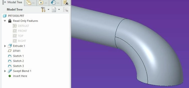

kdirth
October 24, 2019
Don't know exactly the output you are looking for.  Following 5 curves is difficult.  The result probably would not be circular in the middle.
A swept blend would give a nice result if it fits your needs.  Here is an example:
I had to manually divide the end sketch to get the arcs to line up correctly and made the result tangent at one end and perpendicular at the second.

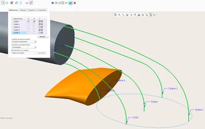

@ kdirth
With Swept Blend, the trajectories and the sections have the same number of elements (the lower curve was divided in 3), the ends still in free :
the function doesn't show a preview ... so it means it is impossible.

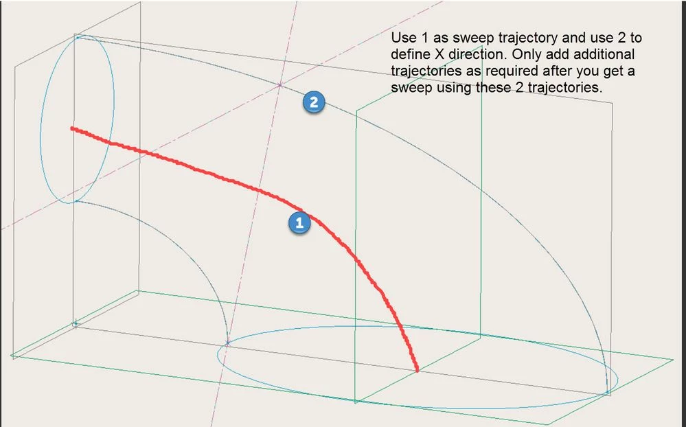

tbraxton
October 25, 2019
See this picture for something to try using VSS. Create a curve along the center of the section as it will be swept between the proximal and distal ends of the sweep.
I could tell you more if I had them model to look at. If you do post the model it must be in Creo4 or earlier for me to open it.

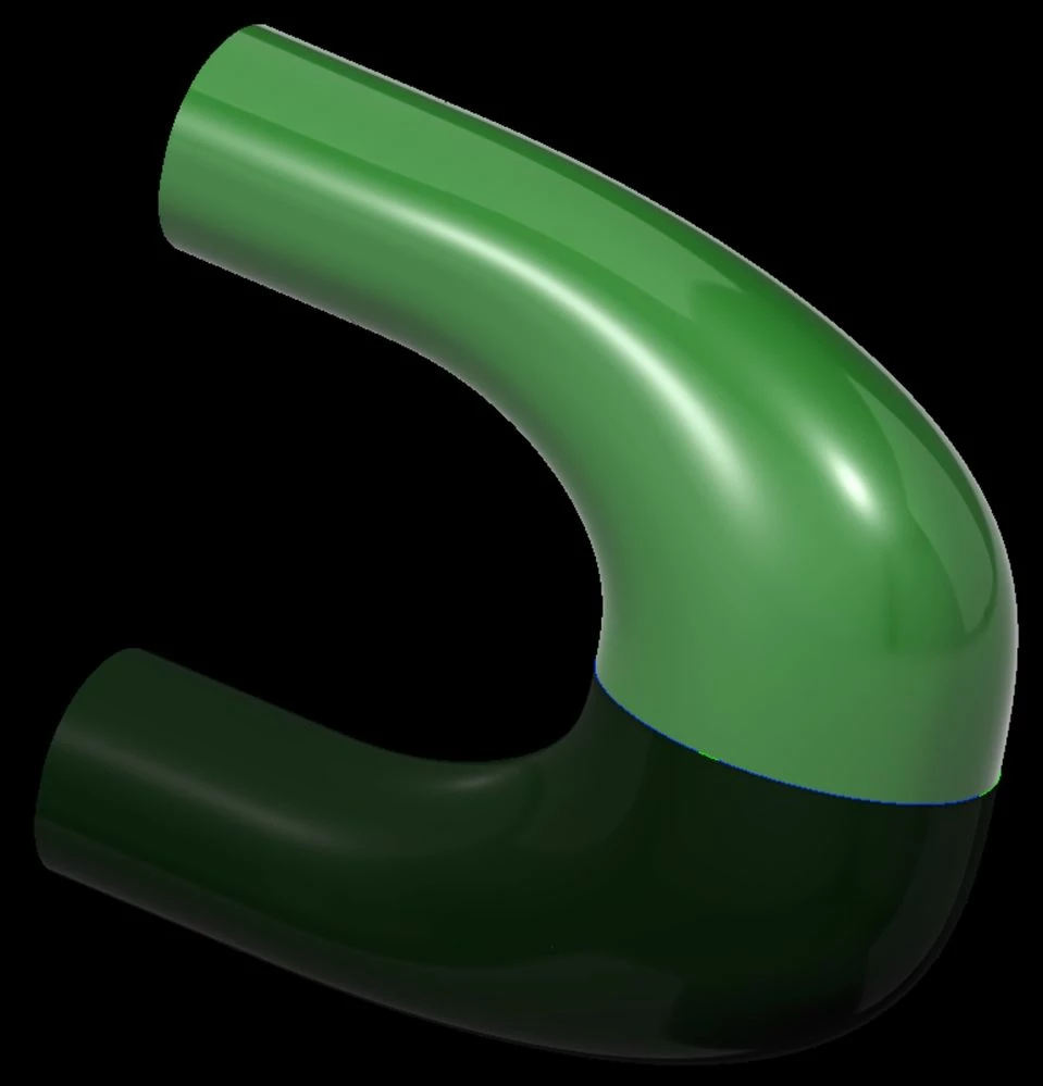

Patriot_1776
October 28, 2019
Not having your actual geometry, I eyeballed it.  Using both loops as-is resulted in a weird "pinched" area on the bottom inside surface, leading me to add more control to stop that.  I made one B/B (boundary blend) surface from the vertical centerline plane of the part, assigned continuous conditions to the ends, and normal conditions to the Front datum, then simply mirrored and then merged it.  I didn't bother making a solid.
What I did that was a little trick I learned, was that I could have used a datum curve on the Front datum and simply assigned a curvature continuous on both ends.  But I don't like that because you can't specify HOW "continuous" it is.  That's why, I added features 12 thru 15.  This way, I can add a B/B to use as a edge and use the extruded layout surfaces to be continuous to, and use the drag handles (Constraints tab, "Display Drag Handles") to pull the shape into what I want, something you CAN'T do with a simple datum curve.  I use this technique a lot when I want more control.  I could have cleaned it up more in the area of the solid itself, but I think this illustrates the point.
