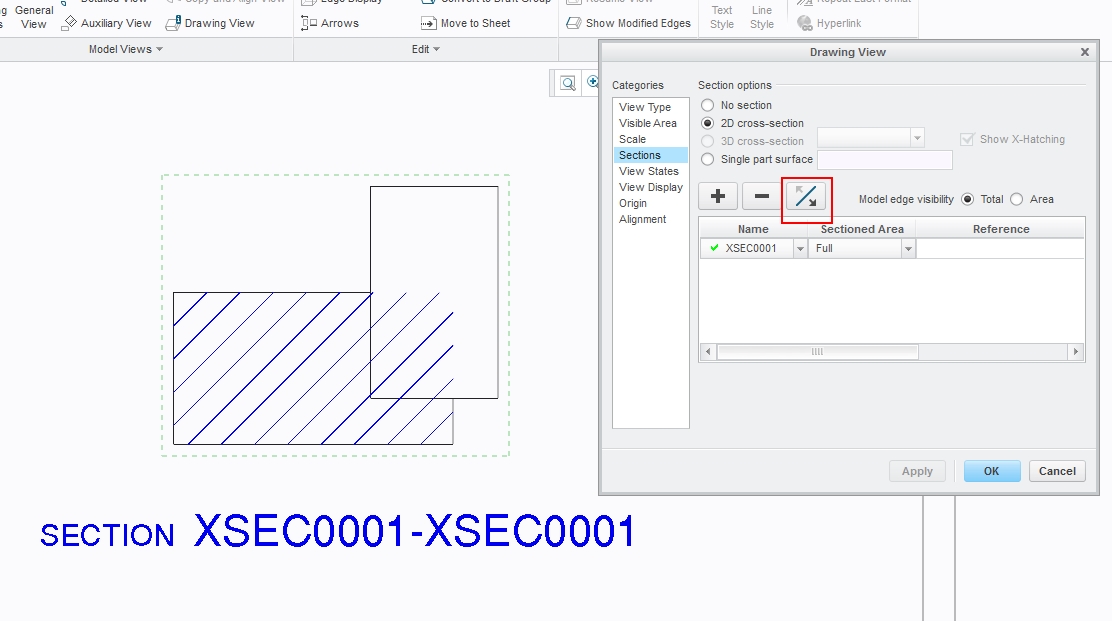

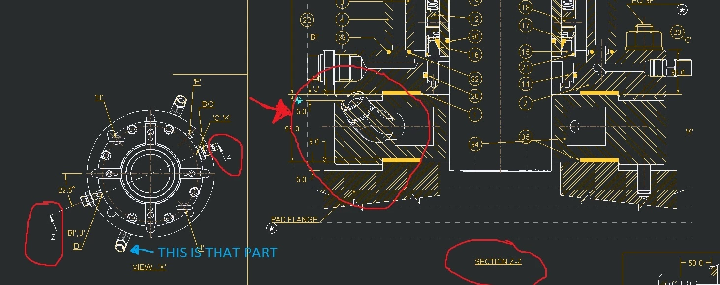

I Am Facing A problem In Section While Detailing In drawing File. The Problem Is That, When I took A section Of My Assembly in drawing mode; then 'The Part Behind My Section' Appears In Between My Section View (drawing view). Which Part Should Not Be Seen in this Section. Which Means This Part Is Invisible In 3D Assembly File When I Activate A particular section.
March 17, 2016
Is nozzle perhaps a surface part ei. no solid?
rmore4-ParticipantAuthor
March 17, 2016
it is solid part.
kdirth
March 17, 2016
Is there a quilt in the part?  Models from suppliers sometimes come as a solid with a quilt depending on how the made the IGES or STEP.
March 18, 2016
Ok I finaly managed to recreate your problem on my test model.
You probably made xsection of view in drawing and then clicked "flip material removal side without re-orienting".
You can choose xsection to show area not total that will remove nozzle or flip removal side again.

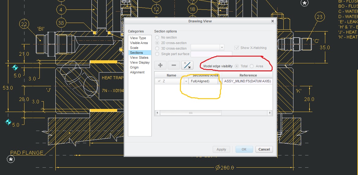

March 18, 2016
Thanks Mr. Davor,
But Actually I am Using This Section With Full(Aligned) Option. And While Using This section 'Model Edge Visibility' IS Locked for use.
