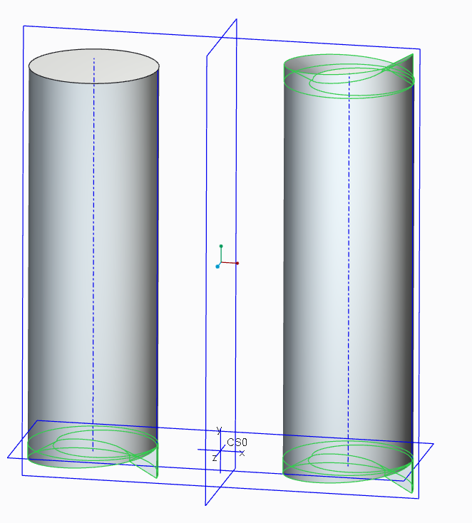

I opened up a case on this because it doesn't make sense that we have to jump through hoops to get a thread complete on a shaft using helical sweep. This should be a simple one-button command and all too often it fails. All kinds of "solution" are provided here on the forum and the Pro|WorkAround feature, but a useful explanation still escapes us.

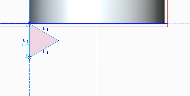

The problem is a helical sweep where the "theoretical" thread cut as a perfect triangle (60/60/60) where the legs are equal to the thread's pitch.
Seems simple enough, right? Reasonable request that you can run that cut feature right off the end of the part, right?
Excusses aside... there is no reason for this feature to fail. And it doesn't fail if you stop short of the end.
The rod is 1" and the pitch is .25. The sketch is tangent both to the surface and the edges are "sharp". Most of us think this simply cannot be done... but obviously it can, just not the way we need it to in 95% of use-cases.

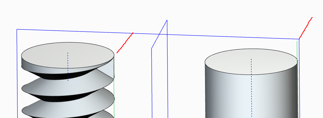

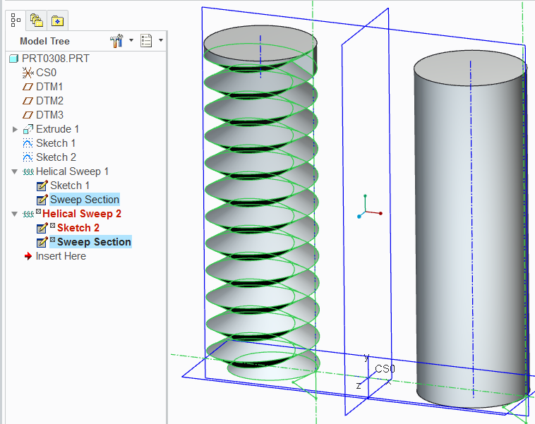

This is the only difference:
And if you don't use the remove material option:

This is why real threads have a flat or round on the thread crest instead of a sharp edge. The sharp ones fail.

I feel your pain. I'd found that the helical sweep definately has it's limitations. What I usually did, if I used it at all, was make sure the section was normal to the axis (actually how the thread angle is measured), and made it a surface that extended slightly beyone the solid. No matter if the surface self-intersected, but I found that was causing a lot (pretty much all) of the failures if it was a SOLID cut. The solid self-intersected and failed. Then I used the surface to remove material. I found that seemed the most robust way. Once I started doing that, I had very few failures.

I forgot that I can make the guide surface (edge) using the helical sweep.
