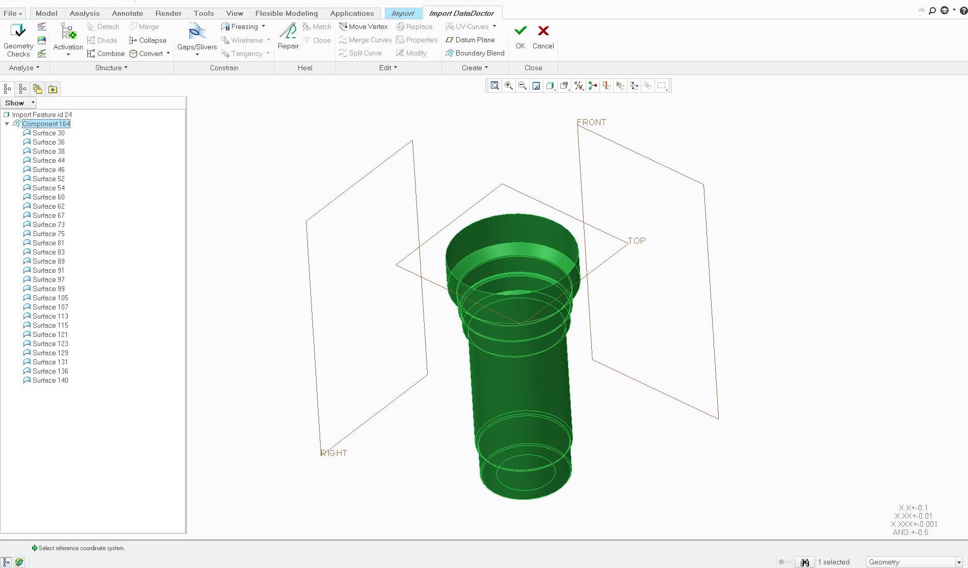

Are they importing and solid, or are they broken quilts? The first step is fixing them to make them solid, if they are not.
I have had a ton of good luck with the flexible modeling. Even imports where I adjusted feaures that had a bunch of radii updated perfectly.
It also depends on what (and how many features) you want to edit.
January 14, 2014
I highlighted Component 164 after removing the block around the hole. Selected Repair, checked Repair Tangency and Ok. Is that what you mean by making it a solid? hf.jpg
January 14, 2014
No, using this method, I would exit out of IDD mode and then draw a surface over the top opening, then merge, then solidify. If the bottom is open (can not quite tell in the picture), then you have to close it with a surface also and merge it before the solidify.
Again, this is just one of the many methods of using this geometry, and in my opinion usually deciding how to use the geometry is trying to have some thought on how you are going to need to modify it in the future, which is how I tend to do all my modeling anyway.
