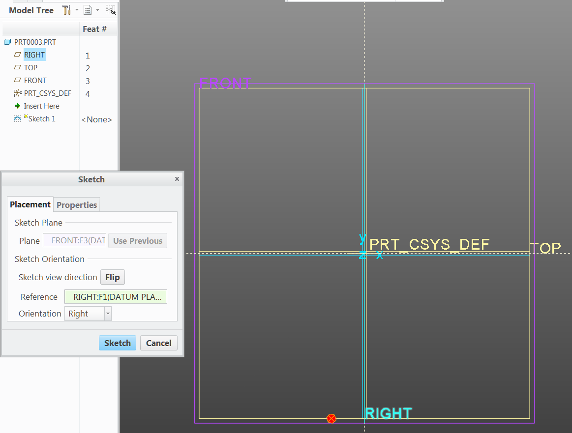

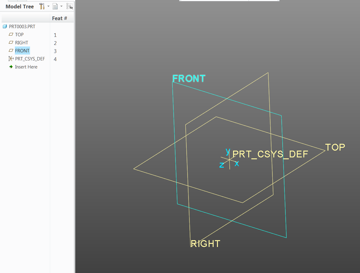

The way I remember the default orientations is to imagine I'm facing an object such as a computer screen.  The front faces me, the right side is "my" right.  the top matches my up.  Also X grows to the right, Y grows toward the top, and Z grows out the screen toward me.  (for the defaults)  (order of rotations follow right-hand-rule.  if Z is your thumb, X is your index finger, and Y is your middle finger. (XYZ, YZX, ZXY - from thumb-index-middle) and the rotation around the thumb axis is in the direction you'd fold your fingers to close to a fist.
Automatic Sketch Orientation (in my experience):
when you choose a datum plane to sketch on creo does 3 things:
1) sets the sketch so that the plane normal is facing toward you.
2) sets the up-direction such that the datum plane moves the least.  in other words, if you had the plane you were choosing in the exact position you wanted to start sketching, it won't rotate at all.
3) sets the sketcher orientation reference to the first available datum plane. and chooses the orientation mode that matches the creo-decision made for step 2.

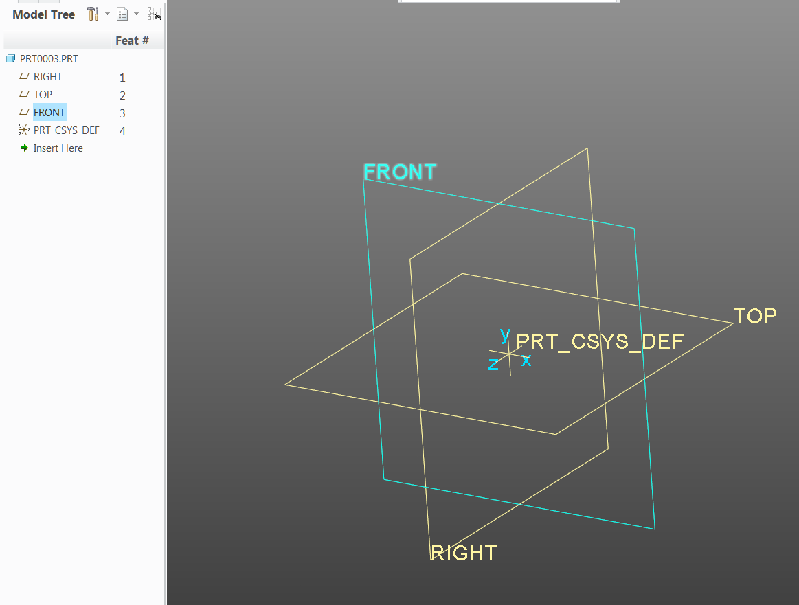

Assume the default 3 datum planes from the standard mmns_solid.prt template that ships with creo.  Datum Plane Order is RIGHT, TOP, FRONT.

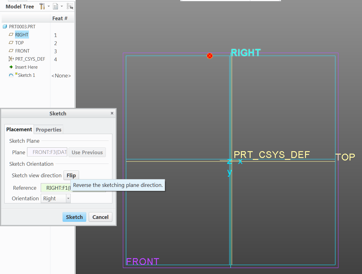

if you choose "RIGHT" datum plane to sketch on, creo will rotate the sketcher so that the datum's normal is pointing toward you, as close to the same orientation as you had.  Then will use the "TOP" plane as the orientation reference.
For your first example you are not actually asking for a front view.  you are looking for a front-facing view, which is the back view of the object.  That is, you are looking forward as if you were the object, but in actuality since you are outside of the object, and looking at it, you are looking at it's back side.

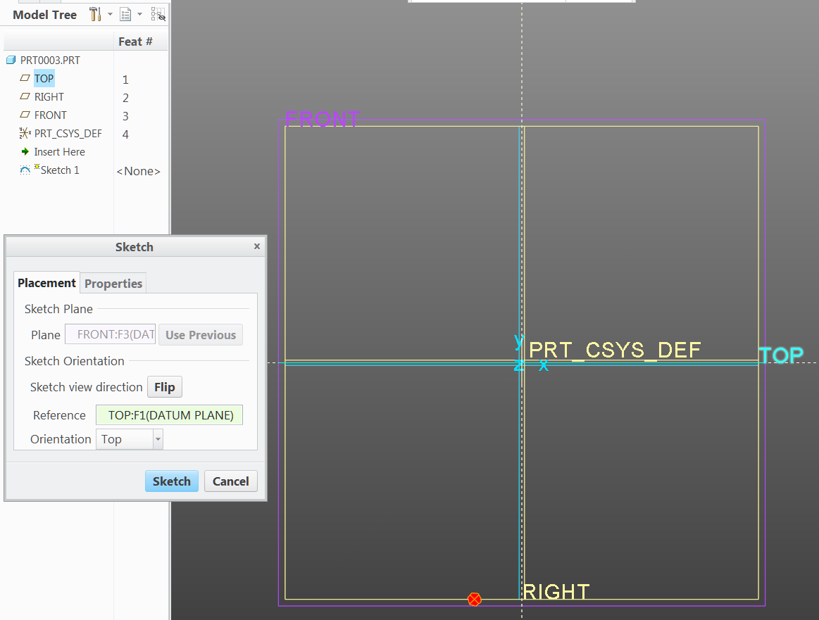

So for your example, you choose the "FRONT" datum plane and if creo defaults to using the "RIGHT" plane as your orientation, when you "flip" the orientation it will turn your sketch plane upside down while flipping it.  If instead you move the TOP datum to the before the RIGHT datum plane, then when you "flip" the orientation it will rotate your sketch plane around the vertical axis because the orientation reference would be the TOP plane instead of the RIGHT plane.

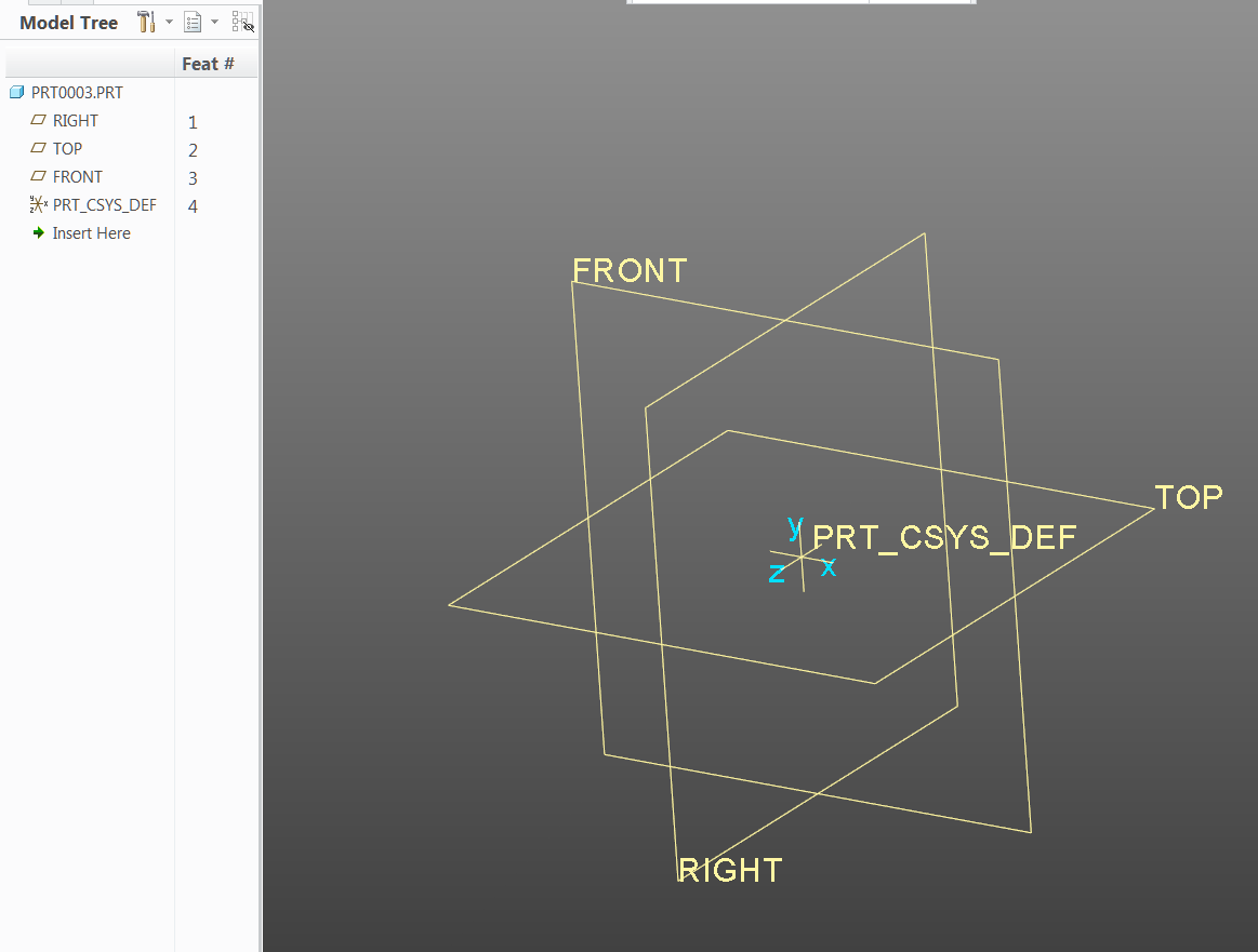

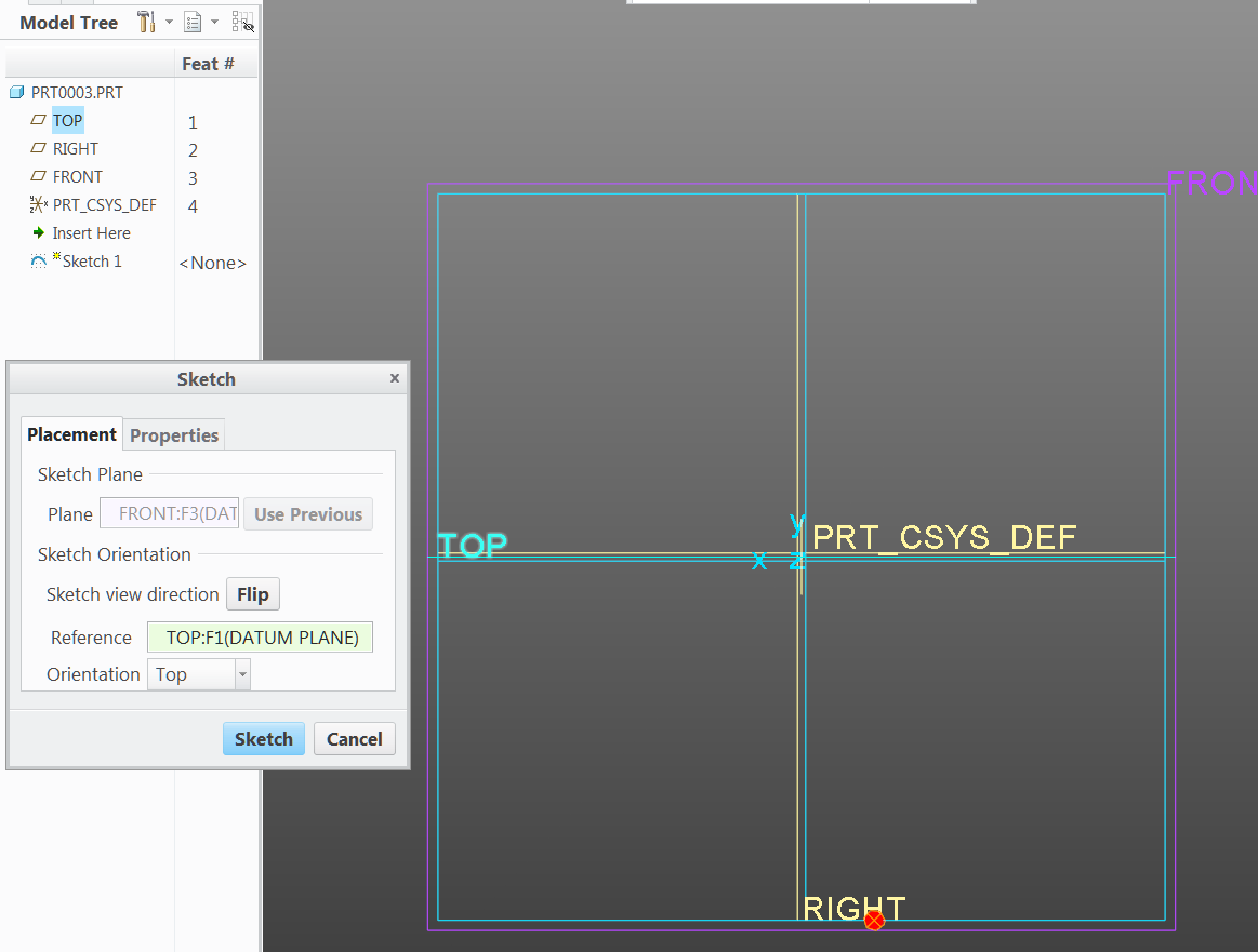

as:

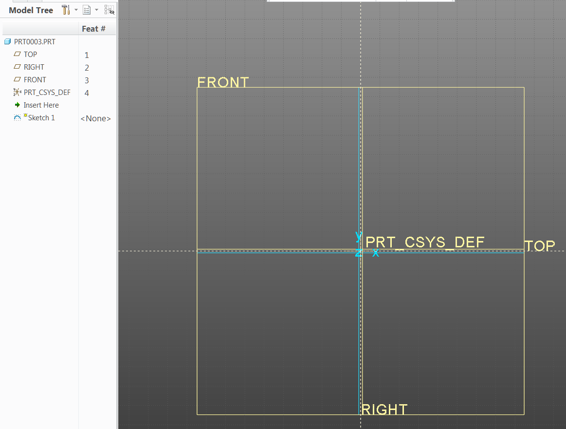

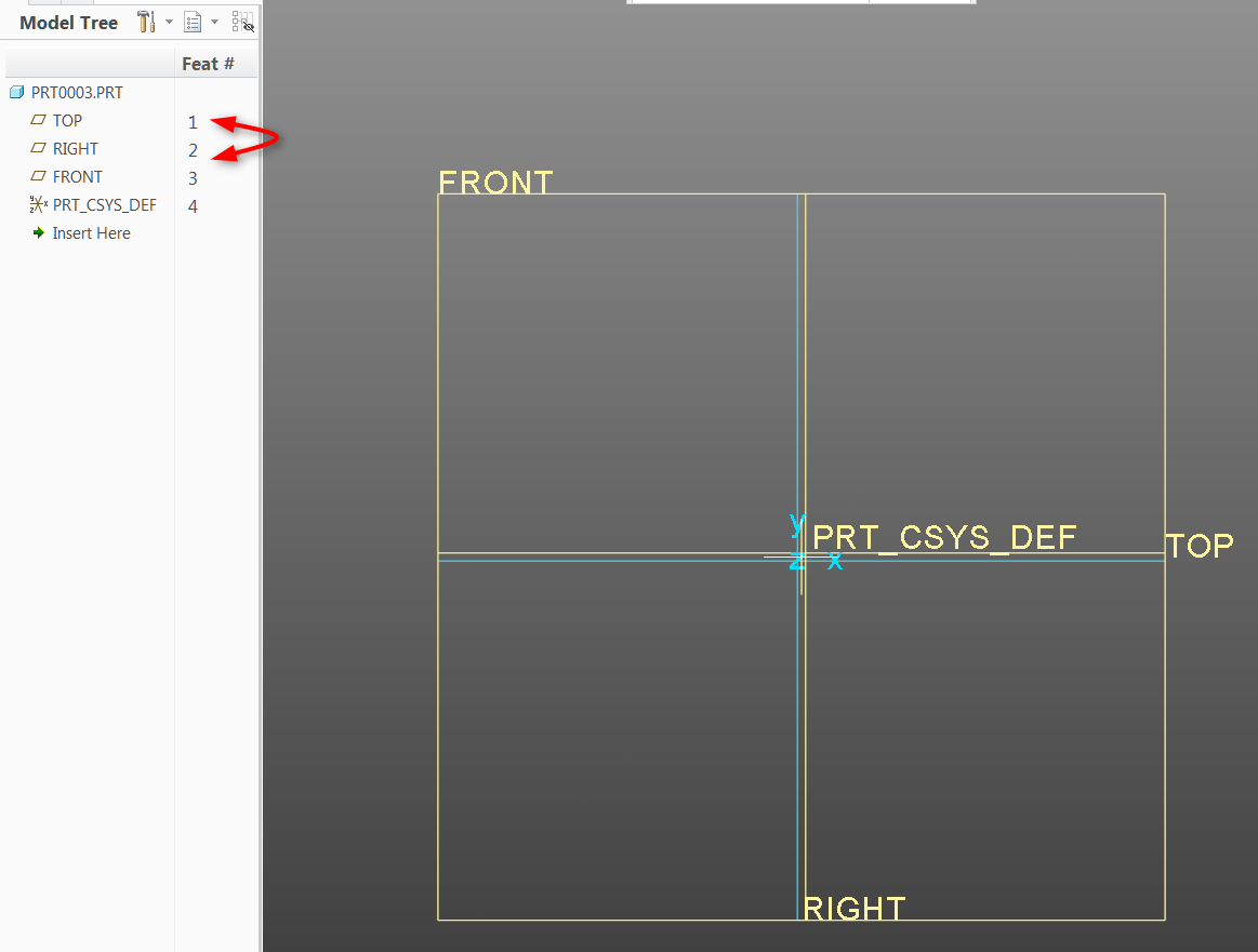

WHEN YOU REVERSE THE ORDER OF THE DATUM PLANES, THE SKETCHER ORIENTATION DEFAULT PLANE BECOMES TOP INSTAEAD OF RIGHT.
NOW FLIP THE PLANE AND TOP STAYS FACING TOP!!!!  (This is the order I have my planes in my start part and it saves me a ton of headache))
