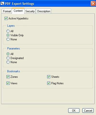

March 12, 2010
Jeff,
Try to click CONTENT -> VISIBLE ONLY (It's like WYSIWYG), if you have the centerlines on your drawing it show display on your PDF.
Good luck,
Calvin
