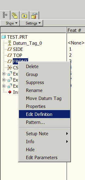

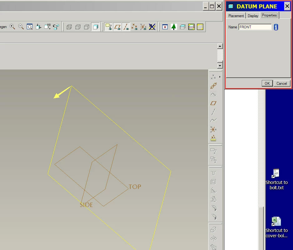

Sorry for the delay in responding, vacation and all... Found this solution to this issue a while back; when you name a datum feature and then delete the feature and the name is "locked off". AND you need to USE the name for something else... typically it's something like a -A-, -B- or -C- datum... You can run a simple example by creating an extrusion with a hole in it, setting the hole axis to datum -A- then redefine the sketch, deleting the hole (and thus the axis) which will "lock off" the name -A-. If you follow the steps below, you can "free up" the name...
[cid:184292009@18072011-29ED]
The tricky part is that you HAVE to use the edit definition box to do the renaming... IF you simply select the item, RMB and hit Properties, you'll get the "name already exists" when you try to rename to the "locked off" name.
[cid:184292009@18072011-29F4]
And then select the properties tab:
[cid:184292009@18072011-29FB]
I got this to work just as described. It seems to "flush" the name that's locked up out of the system so you can use it where you NEED to.

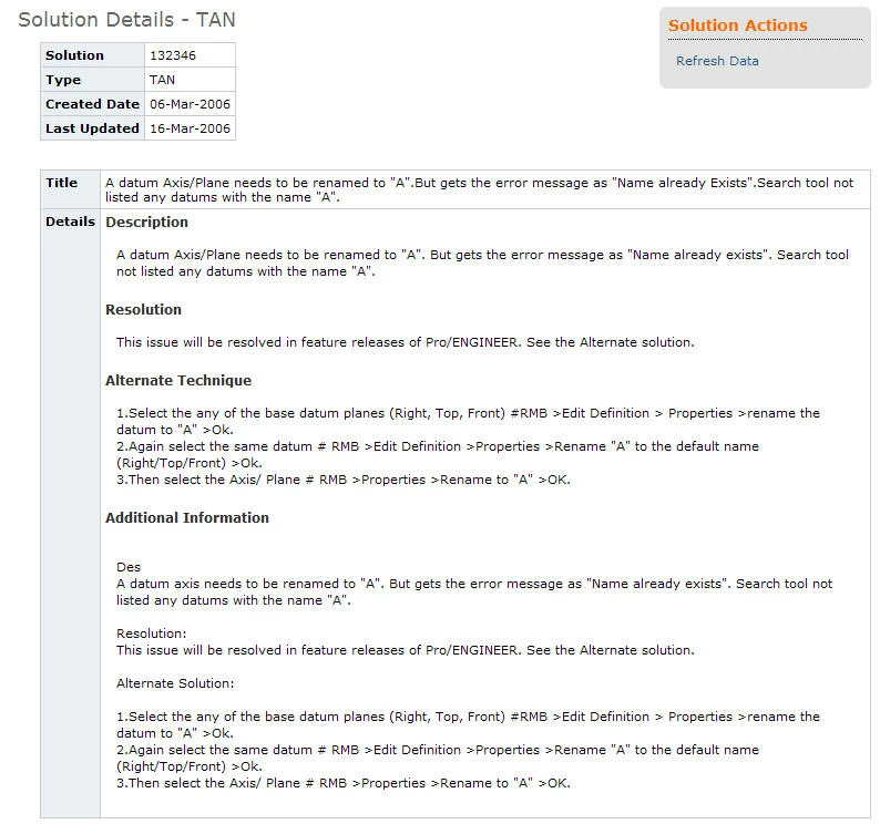

July 18, 2011
FYI
The solution attached worked for us
