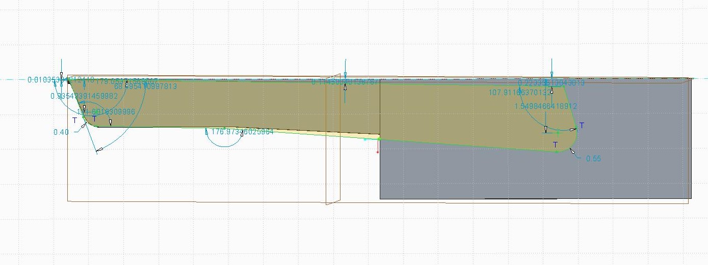

January 14, 2014
For instance, here is a screen shot of what I'm trying to do. I have my sketch imported, exactly the dimensions I want. All I want to do now is make the top line of the sketch coincident with the top line of my existing extrustion (the dashed datum). But if I select to make those lines coincident, instead of rotating my whole sketch and keeping all those dimensions, it will move that top line to be coincident and leave everything else where it is now, messing up all the dimensions.untitled.JPG
January 14, 2014
You can lock the dimensions you like. Lock is available when you have one or more dimensions selected and you right click to get a menu.
Rocks11-VisitorAuthor
January 14, 2014
That does work for the selected dimensions, but in this case even when I select all the shown dimensions and lock them, when I use the coincident constraint, it keeps the selected shown dimensions locked and completely distorts other parts of the sketch that weren't locked. I have also tried selecting the whole sketch and locking it but that doesn't work either. There are always critical dimensions apparently that aren't shown, so they don't get locked. I've tried figuring out what dimensions I need to be locked and making sure I manually dimension them but it never seems to work, there is always some area of the sketch that didn't get locked when I try to move it.

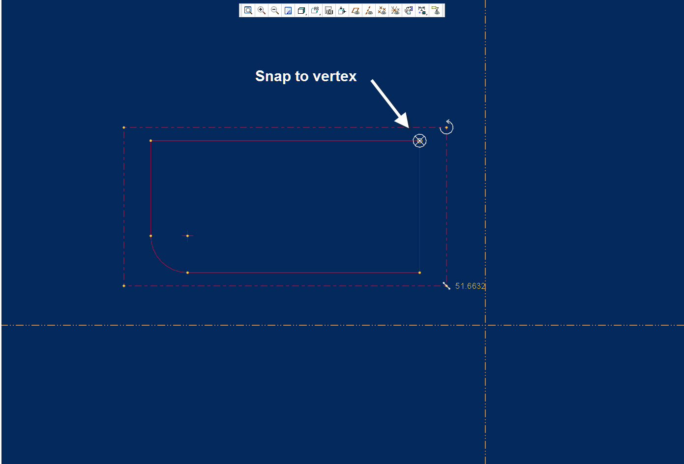

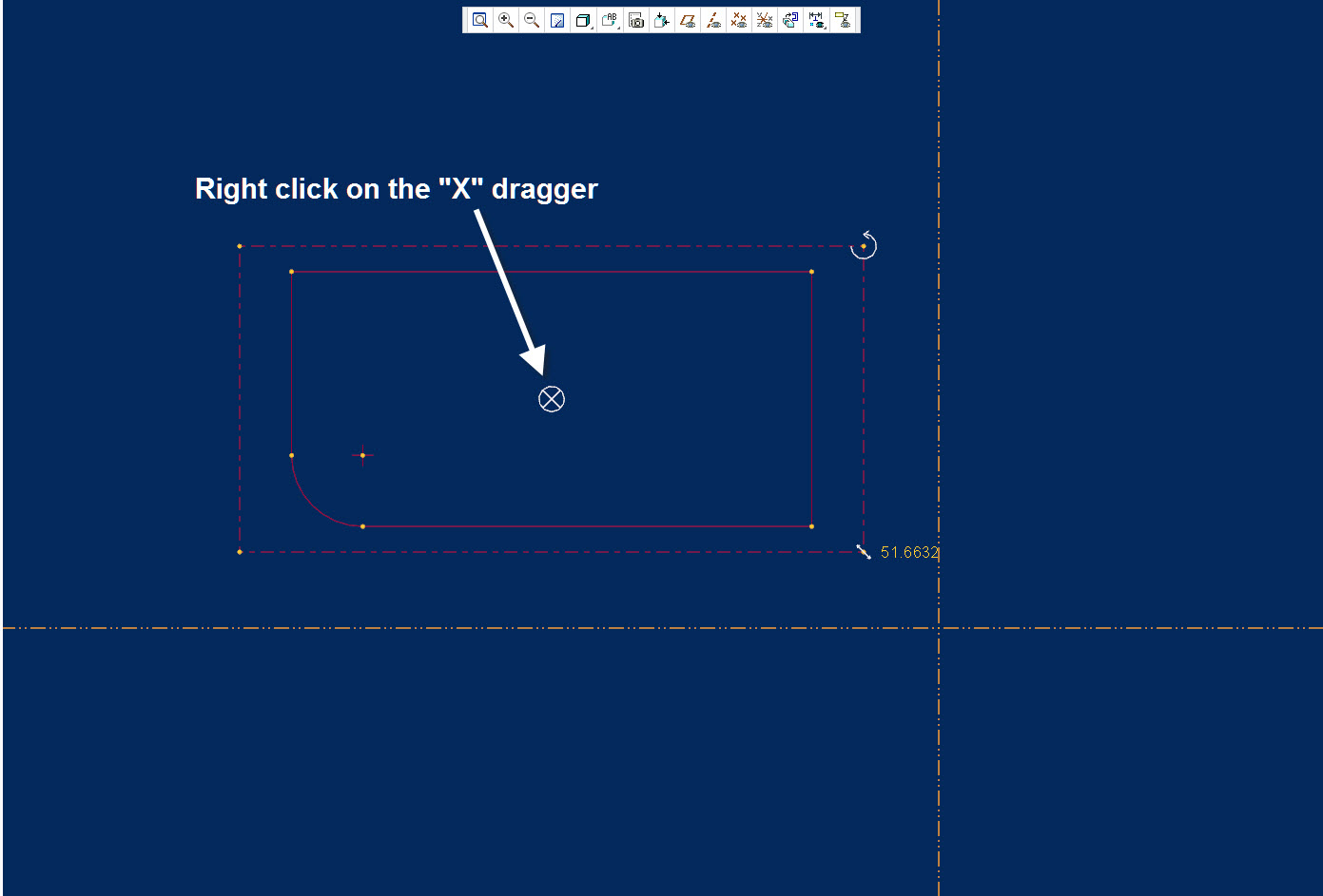

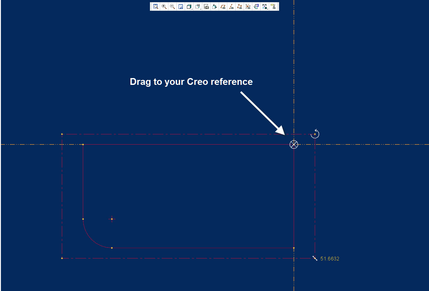

January 14, 2014
Whenever i import a sketch, whether it be from my sketcher palette or from AutoCAD, I reposition the sketch prior to finally placing it. If you right click and hold on the "X" dragger, you can move it to anywhere on the sketch you like and it will snap to vertices or edges. Then use your a left click to drag the whole sketch to the desired reference.dragger-1.jpgdragger-2.jpgdragger-3.jpg
January 14, 2014
Oh wow, this is what I was looking for. I had no idea you could move that X thing. Now my only problem is fixing the rotation of the sketch, I see how I can rotate it if I know the angle, but I need to rotate it to be coincident with my existing line. This is so helpful though.
