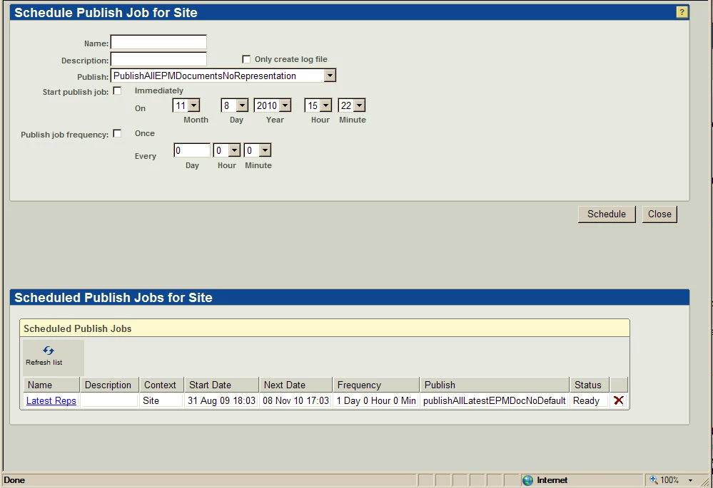

We're experiencing this and a similar issue with the publishing queues.
We are running an out-of-the-box job (see attached). For the most part,
this particular job publishes Pro/E parts and assemblies successfully,
but when it encounters other objects such as .tbl, .cfg, .zip, .sec,
etc, these obviously fail. It also tries to publish items in a user's
sandbox and we don't want those objects published. The numerous
failures are clogging the cue and causing unnecessary ongoing
maintenance to clear it. Is there a way to only publish parts and
assemblies and avoid objects altogether in the sandboxes?
