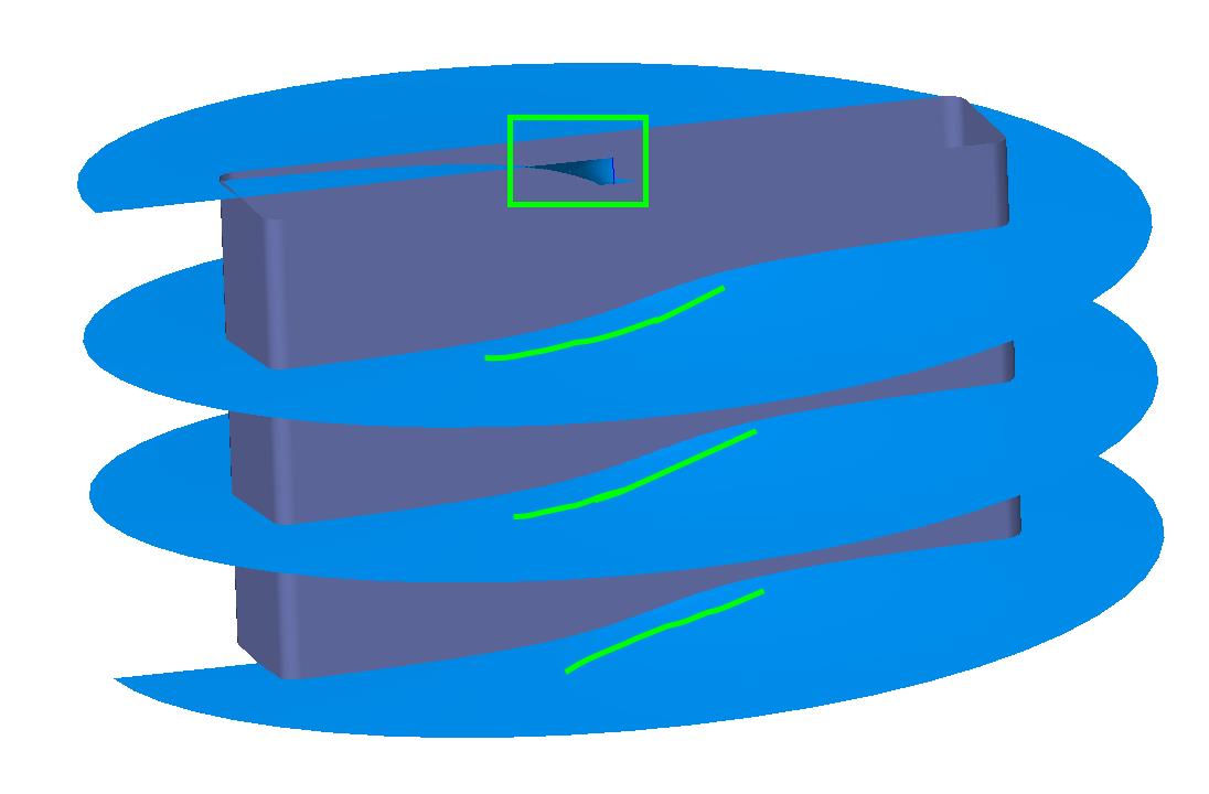

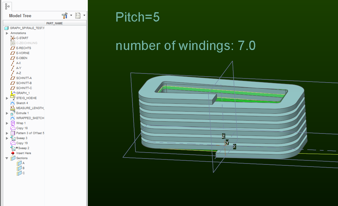

Hello out there,
is there anybody out there who knows how to create a rectangular helical sweep Feature, as in the shown black and white Picture?

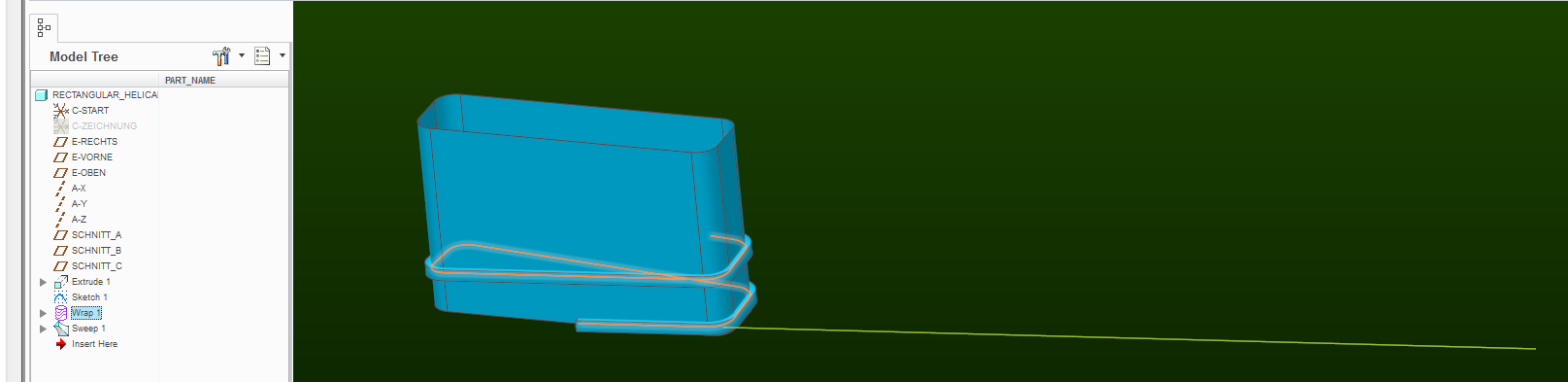

I tried my best to get a solution, but it is not to be used. The gradient is somehow not constant in the red area to the blue area. The reason is the great difference between the inner radius and the outer radius. If the shape of the required rectangle increases, or edge lengths are the same length (quadrangle). Then the slope becomes more linear.
Rectangular helical sweep feature_I.jpgRectangular helical sweep feature_II.jpg
Is there any help out there?
Thanks Heiko

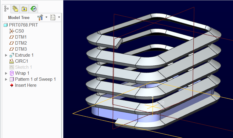

How about using the wrapped sketch, like this:
rectangular_helical_wrap_sweep.png+

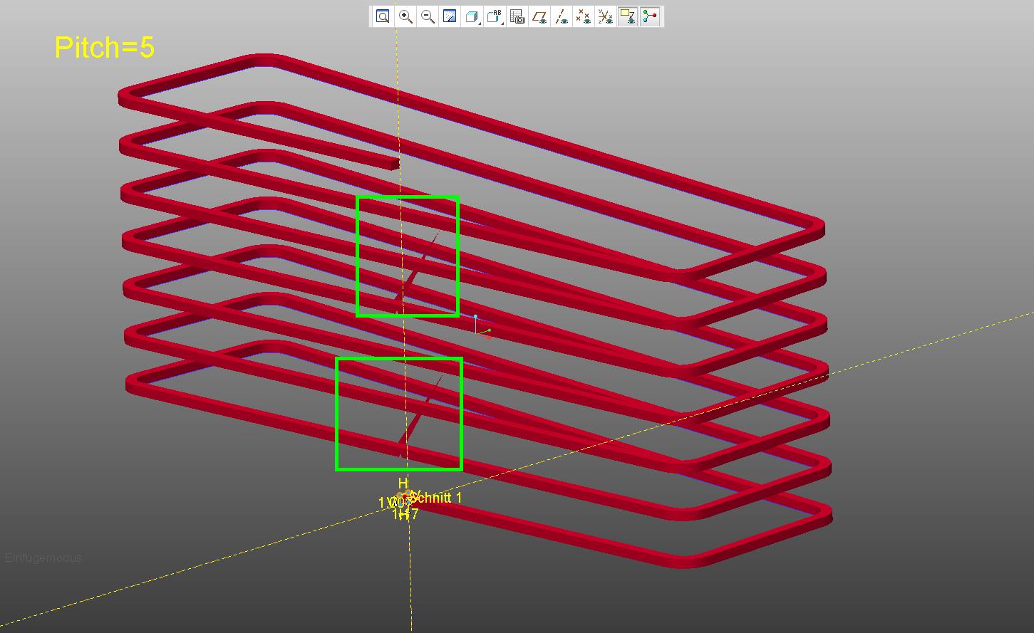

That's why I did a little Research to get a good solution. And here I need help again to have a solution ready for posterity.
Here I compiled a graph with an offset curve and a pattern. So far so good, .... it works mostly but not constant.
The curve in combination with the graph works very well. The Problem is the sweep Construction element.
Sometimes it works and sometimes not. If you change the profil in the sketcher or the pitch. Then the sweep fails
Could you have a look (or somebody else) on this, maybe you know why and what i did wrong about this Position??
Thanks in advance.

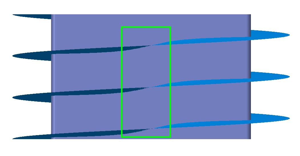

Your black and white picture is not a helical sweep. It is a series of horizontal segments with a sloped step. This would better be done by creating the sloped step, then a related horizontal segment and then patterning the sloped step and ref-patterning the horizontal segment.
February 2, 2017
Glad someone noticed.  Make one revolution using evalgraph, then pattern. Done.

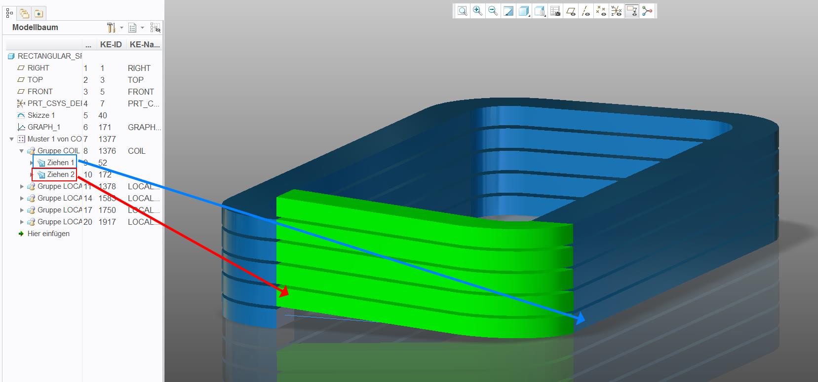

Attached is an example of how to do this using evalgraph.  After you have setup a graph, you setup the relation in the section for the sweep.  I have also set a relation at the part level to set the pattern distance to equal the value set by the graph.
hhagedorn10-MarbleAuthor
February 10, 2017
Hello to all,
first of all thanks for all that help here!!!! Even there is still no perfect solution yet.
Antonius Dirriwachter‌ thanks for your explanation about how is a evalgraph working.
I think I have understood the function with the evalgraph and the trajpar. As far as I can tell. "I'm still a rookie about this"
, I tried to understand the example what you have attached. So far so good. But your example has one serious error.
The slope consists of 2 Sweep's and not one. AND the blue Sweep is completely flat along the curve. Only the green sweep has the slope.
After this diagnosis I tried to use one curve (Skizze 1) where the profile is pulled along. But this only works when the start and end of the curve have a minimum distance.
However, this is technically wrong. It must be closed and only separated in one place.In order for the following curve (patterned) to be combined with the original curve. And no intermediate piece has to be patched.
>> However, if the curve is closed and only separated at one point, the sweep will fail. << I'm getting confused.
Still waiting for a good solution.
February 10, 2017
Correct, I set it up as 2 sweeps, a flat section and a sloped section, as is shown in the black and white image you attached. If you're trying to do it as a constant slope it's the same process.  Attached is one with a constant slope.

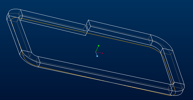

I used a normal sweep together with trajpar it should give the required geometry. to my suprrise the sweep feature in Creo 2 doesn't allow closed curves having a trajpar parameter
February 10, 2017
The original angles the wide section; and it steps only in one of the two short sections.
This is the reason an evalgraph will work well.  It is not a constant rate of "anything" which trajpar can utilize.
However, you can bury the evalgraph in the trajpar statement.
It appears that the angle of the "blade" is constant.  Correct me if that is not true.

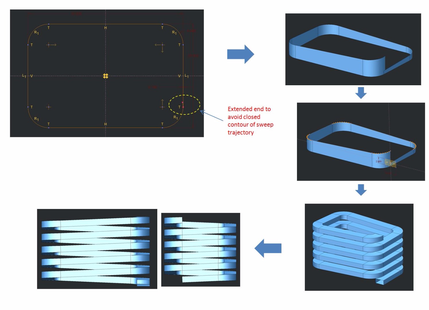

BHOoi
February 15, 2017
This is probably another way to model the geometry. It requires more steps  but I hope it does give you what you wanted. I apologize if I have misunderstood the intent.

February 15, 2017
This would be my entry for this challenge.
It utilizes a wrap to manage the constant rise.
This is fairly simple to make parametric for a variety of shapes.
This method also does not require a "guide curve".
P.S. This is also Paul's solution above and with the clarification, I would suggest his answer is correct.

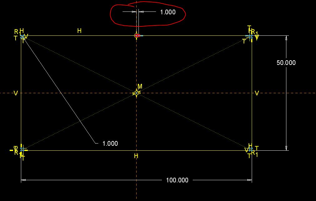

I am getting obsessed  to this a little . I found a way to allow me to sweep along a closed contour in Creo and this allows me to create the helical spring with constant gradient. Just want to share it and please ignore if you are already aware of this trick:
February 20, 2017
You might have just hit the nail on the head, BH.
Are you using trajpar in a sweep?
BHOoi
February 21, 2017
yes, there is a relation in its sketched section. For some reasons, Creo does not allow trajpar to work on closed contour. You may educate me more on this. Thanks.

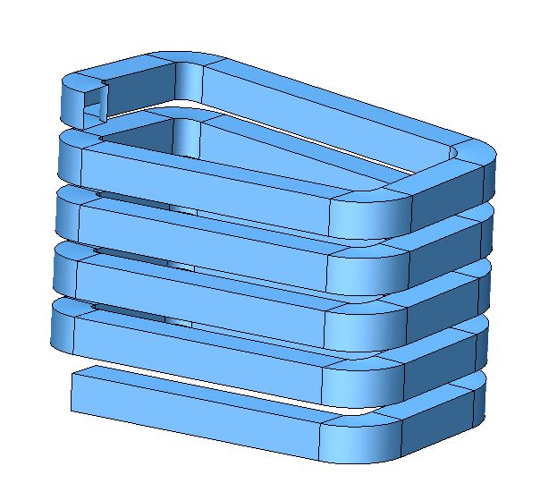

Here is a solution using just three features.
It works also as conical version.
It was created with Creo 3.0. If you can`t open it I also can provide Creo 2.0.
February 28, 2017
I like your approach to this issue....
