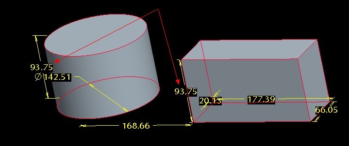

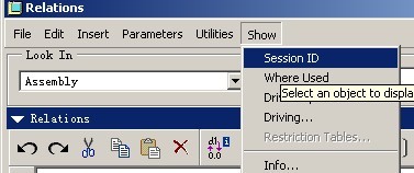

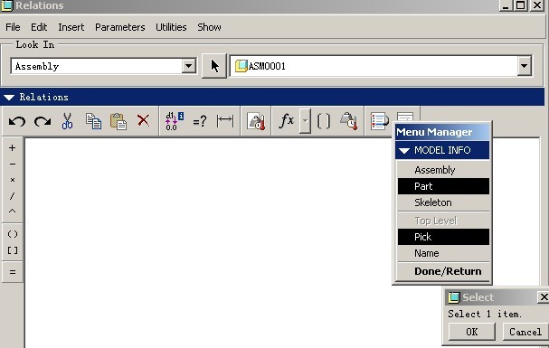

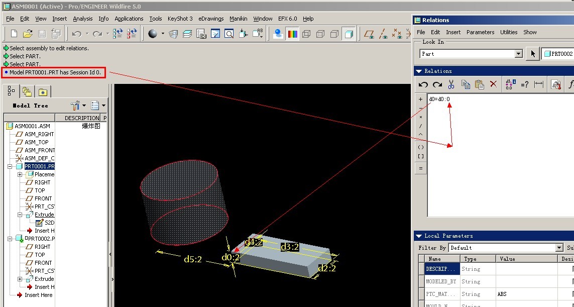

Perhaps you mean
parameter_name:fid_N or parameter_name:fid_feature_name
