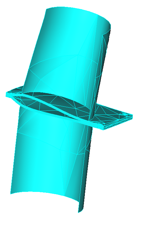

Hi all,
I use Creo 2.

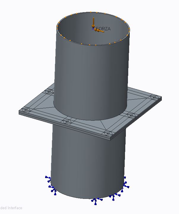

I would analyze this assembly where we have two identical parts composed by a thin plate with 8 holes (for bolts that are simulated as fasteners) and a thin tube that is weld on the plate.
This two structure are assembled together with the bolts, they are constrained at the bottom and there is a bending moment at the top.
In the first test I have meshed all with shells and I have inserted a contact surface between the two plates; but the shells don't support the contact regions.
In the second I have meshed the plates with tetra and the tubes with shells; Creo has meshed but there was so much tetra, due the very thin plate (6 mm) that I suppose it should take many hours to converge...if it can...
In the third case I've tried to mesh the plates with the mapped mesh control, in an attempt to have a more regular mesh with few elements. But I'm not able to link this mapped mesh with the tube above the plate.
Any suggestions?

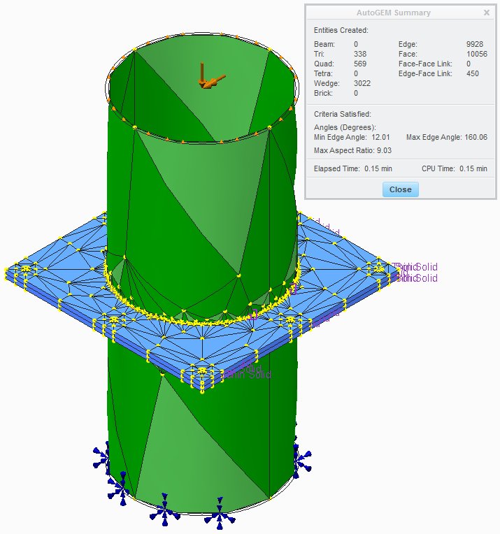

You could use thin-solid elements, but I believe you can't use them in conjunction with the fastener tool; this means that you'd need to manually create your idealized fasteners. A key feature of thin solid elements is that the p-order on element edges through the thickness are limited; this helps reduce computational time but also means you mean apply the same restrictions as shell elements (essentially).
You could also use a prismatic mesh control to prevent the creation of tet elements in the plate. Since these are regular solid elements, you can use the fastener tool with them.

You could also use a prismatic mesh control to prevent the creation of tetra elements in the plate. Since these are regular solid elements, you can use the fastener tool with them.
I've tried before, in other assemblies, to use prismatic elements, but apart some simple cases, the mesher cannot create the mesh and it resorted to tetra elements.

I played around with your model and it looks like neither will work; both thin-solid elements and prismatic elements cause issues with pairing the linked elements (which is due to the contact interface). I'll have to play with it some more when I have more time, but as of now it looks like a standard tet mesh is your only option.

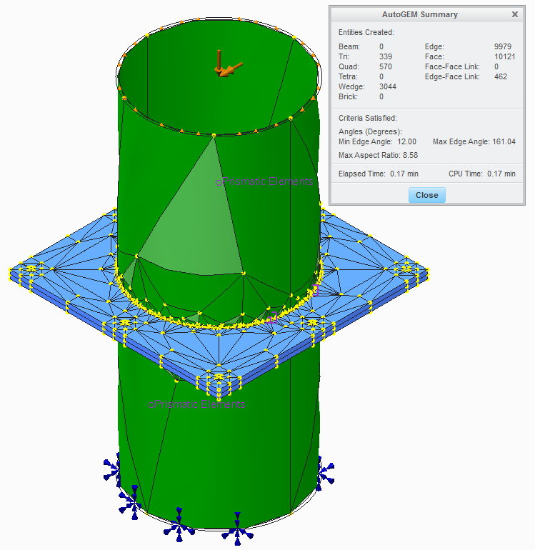

In my experience "prismatic elements" works only on prismatic solids without holes; "mapped mesh" needs guide lines (I have done volume regions), so much time and it don't work if the entire assembly is not mesh with that tool.

The utilization of prismatic elements is not possible if you want to use the fasteners to let the plates in contact. It seems that only tetra elements can "support" fasteners.
You can utilize prismatic elements with solid bolts preloaded with thermal load or the creo 2 preload feature but, if you want to maintain the contact surface between plates, you must remove the flag on the voice "Generate compatible mesh". This also means that, not having the compatibility between the nodes on the interface, probably it will require major time to get to convergence (maybe, I'm not sure 100%).
