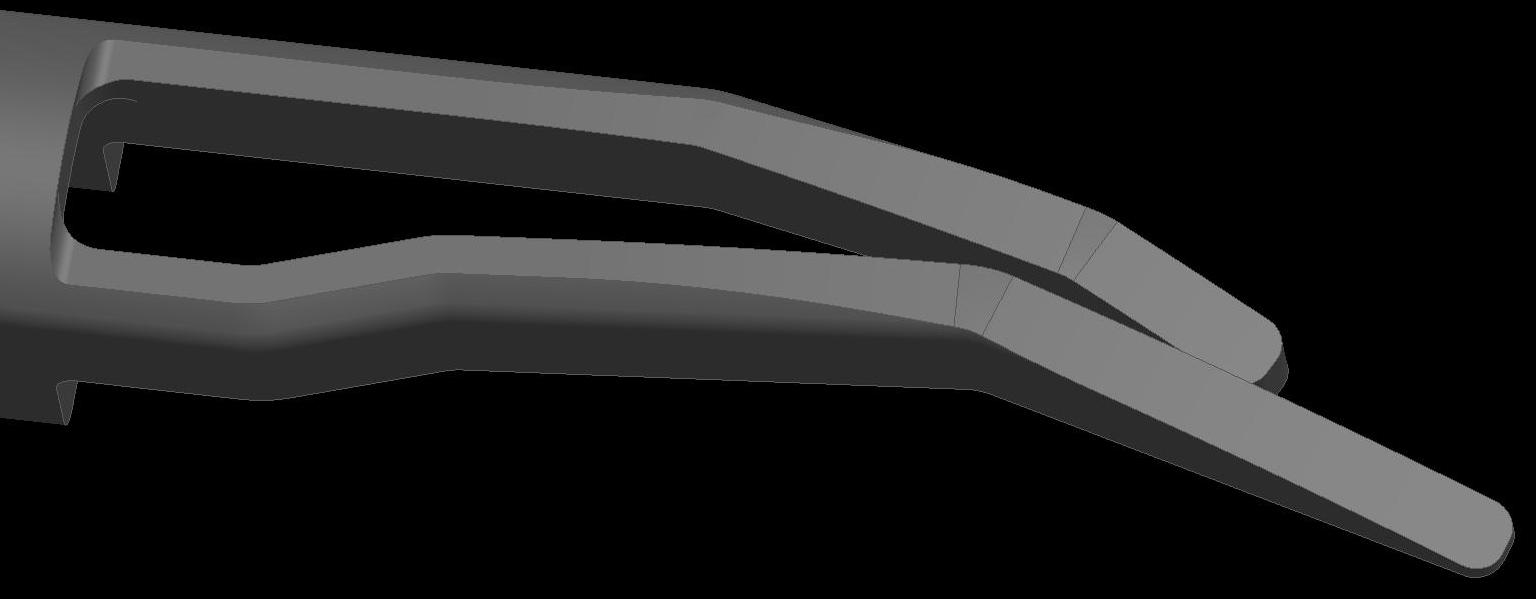

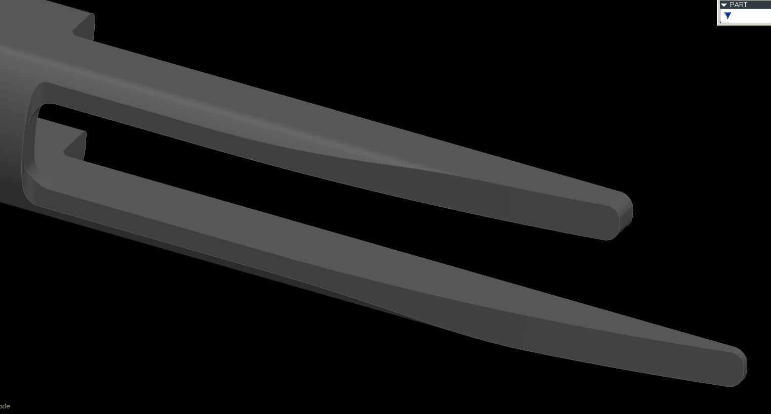

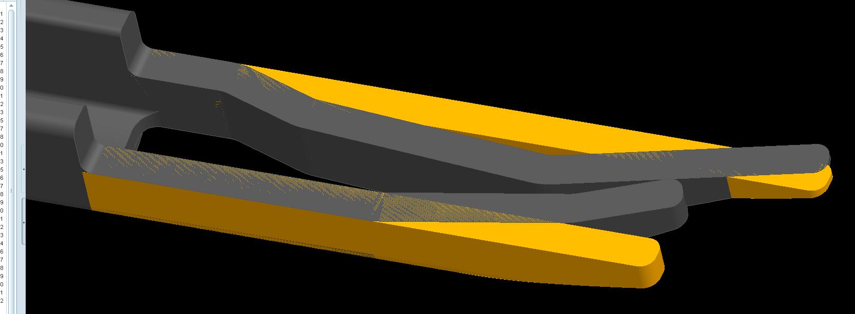

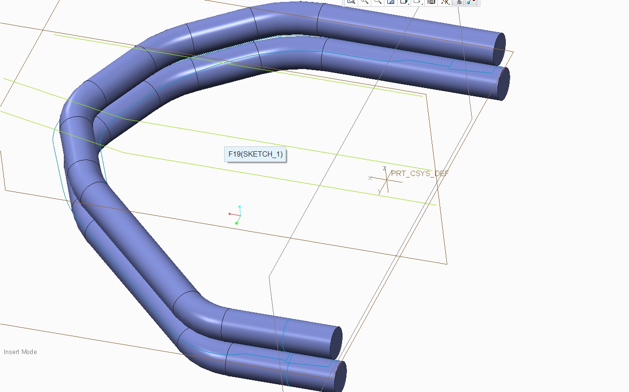

It's a powerful command, but a little tricky until you get used to it. The plane "defining volume to bend" means just that. For instance, if you have a tube with holes in it that's 10" long, and your 2 planes are 5" apart, that 5" will be stretched the length of that spine, however long that is. Conversely, if your planes are 20" apart, it will compact that volume along the spine length. So, to eliminate or minimize any distortion, make sure the planes are where you want them, and that your spine is the correct length (in this case, 10" total).
So, for the parts you see below, I made a sketch of the geometry I wanted. I knew that the legs would be made from an extruded shape, and then have a radial cut normal to the extrusion's centerline. Then, the legs would get bent, but I wanted to have the inside length of the bend remain the same and stretch the outer length. So, I created a datum curve of the geometry for both legs I wanted. Copied the inside curve segments I wanted to use as a spine separately for both legs as it's own curve. I then used an evaluate feature and a relation to drive the surfaces I extruded and merged with the radial cut. I did surfaces because I had 2 spinal bends to make, and it allows greater flexibility as when I'm all done with the spinal bends I can solidify them whereas if you're trying to bend a solid, you get EVERYTHING in that "volume to bend". Then I used 2 spinal bends to get the final geometry. I did this becase I have a family table with instances of this part in the raw, extruded length, with the straight legs length (for the vendor), and with the final bent length. It seems to have worked out very well as the vendor is really happy I can tell him the length of the legs to start with, and as you can see the geometry is correct for the cuts (normal to the sides not normal to the extruded centerline).

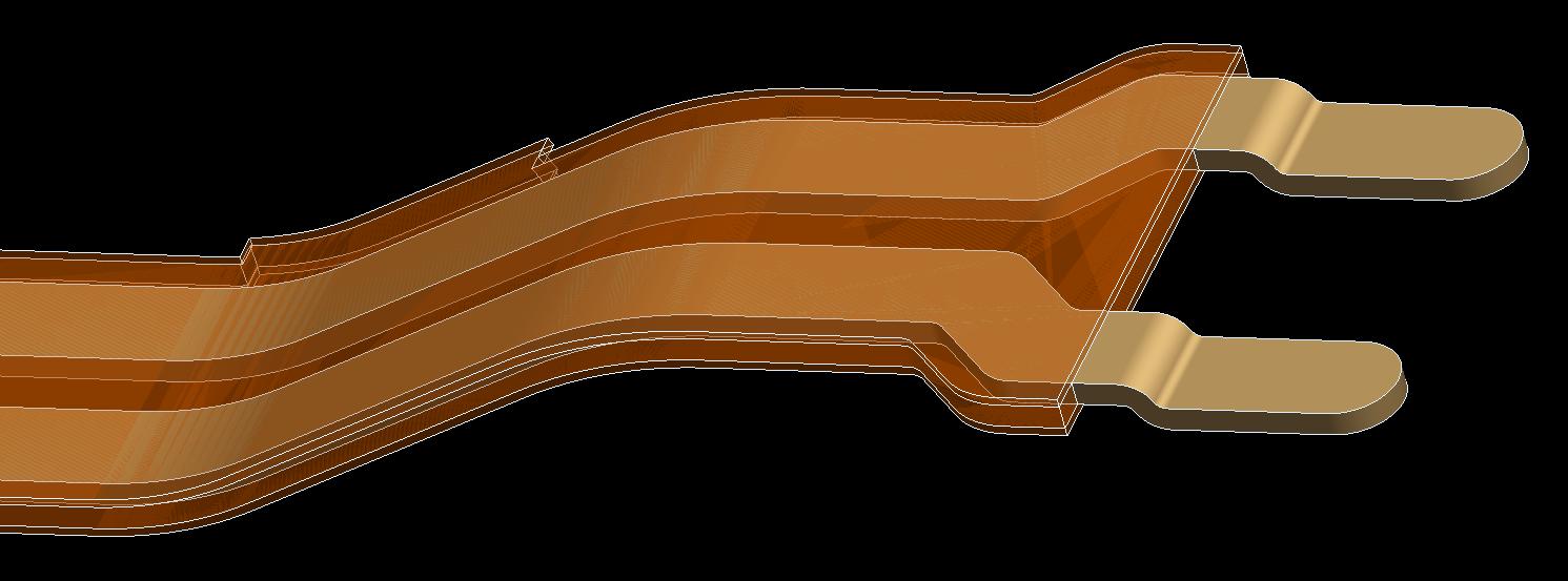

More spinal bend fun. This time, I had a flex circuit assembly that needed to be in 3 different states: Flat, with just the leads bent (for soldering), and with the leads bent and bent in the final shape. It needed to be an assembly so that I could get different cross-sections for the different layers. So, I had to do 9 family table instances for the basic parts, then 3 different instances at the assembly level to get it all to work. Too bad you can't do a spinal bend on an assembly at the assembly level.
