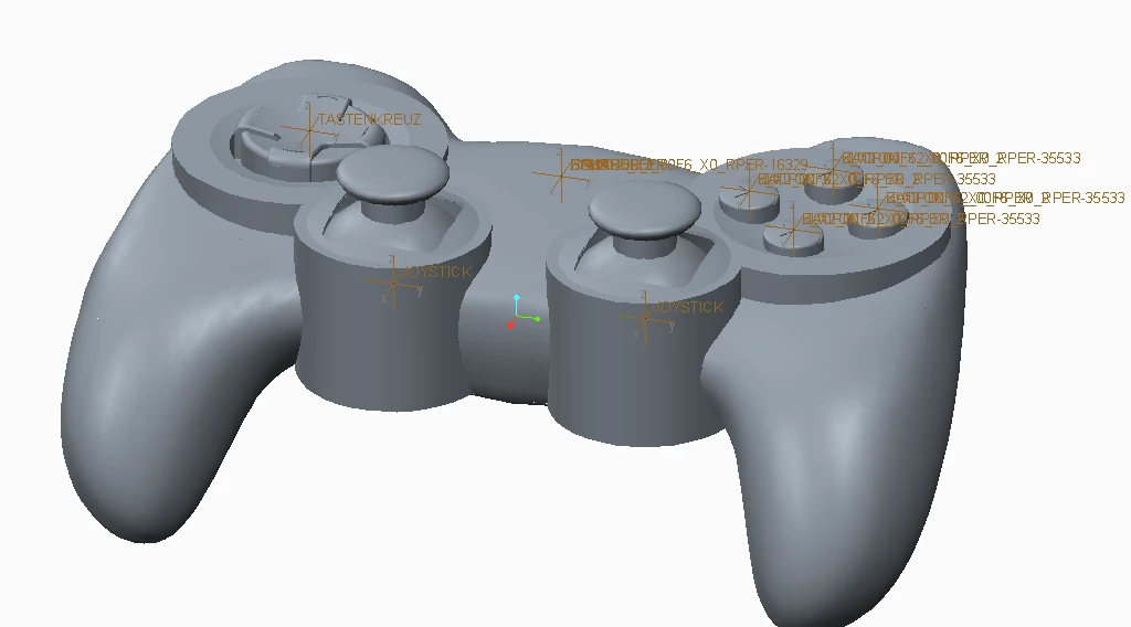

Hello everyone, I'm sorry if this is a silly question, but I thought it would be better to ask then to keep struggling. So, I have a model in Creo Parametric, which I would like to create a case for. Instead of trying to spend hours modeling the case by hand, is there a way I can essentially vacuum mold a sheet to the part, and get a perfect mold of the back of the part? If so, how would I go about doing this? Thanks,
-Jonas
P.S. Attached is a picture of the part, Game controller, for which I woul like to mold onto. I want to create a box with a perfect depresion to set the controller in.

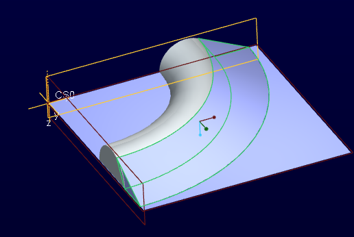

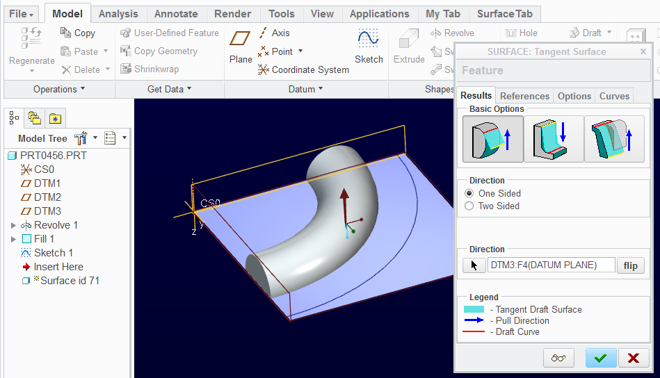

The appropriate tool for this is Tangent Surface. Go to the help files to get some tips on using this.
Attached is a full version Creo where this is done.
I am assuming you know how to copy the exiting surface and how to set up the vacuum form plane. Determine the draft angle you want to give the case and build you tangent faces from the edge of your copied surfaces. The attached version is simply a connection between the tangent and a sketched boundary.

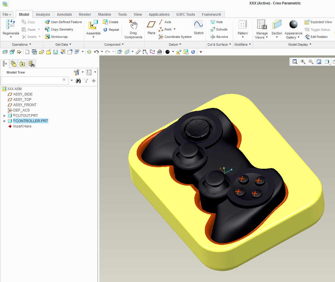

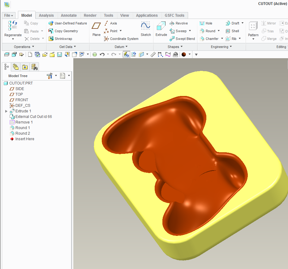

You might also try a Merge/Inheritance CutOut to generate the basic shape. You can then use surface offsets or other surface trims to create an accurate 'shell' to hold your controller...
Shown with the controller added in an assembly...

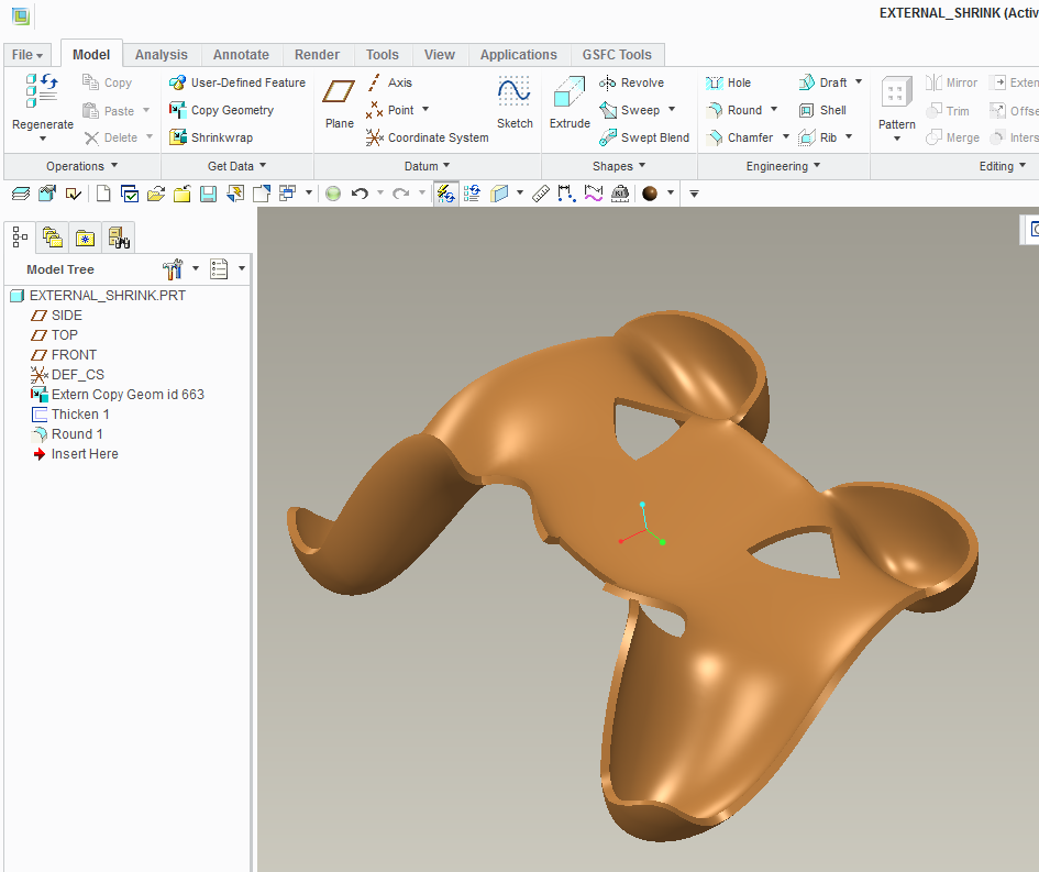

Alternately you can use a technique similar to the one David linked to create an External Copy Geometry and then thicken the resultant surfaces... similar to this...

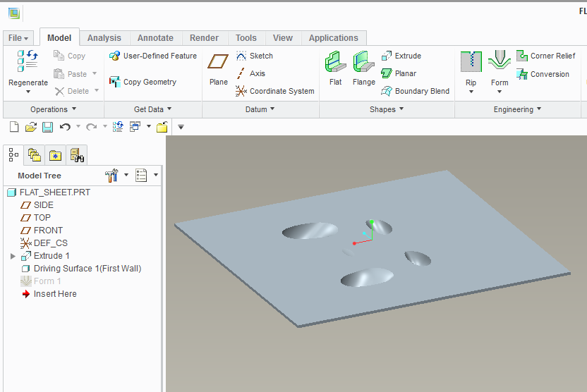

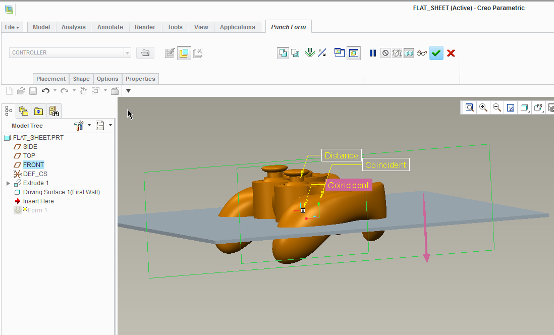

Finally, you can use the sheet metal module and use your controller as a form as shown below... first add the controller as a form feature (punch)...

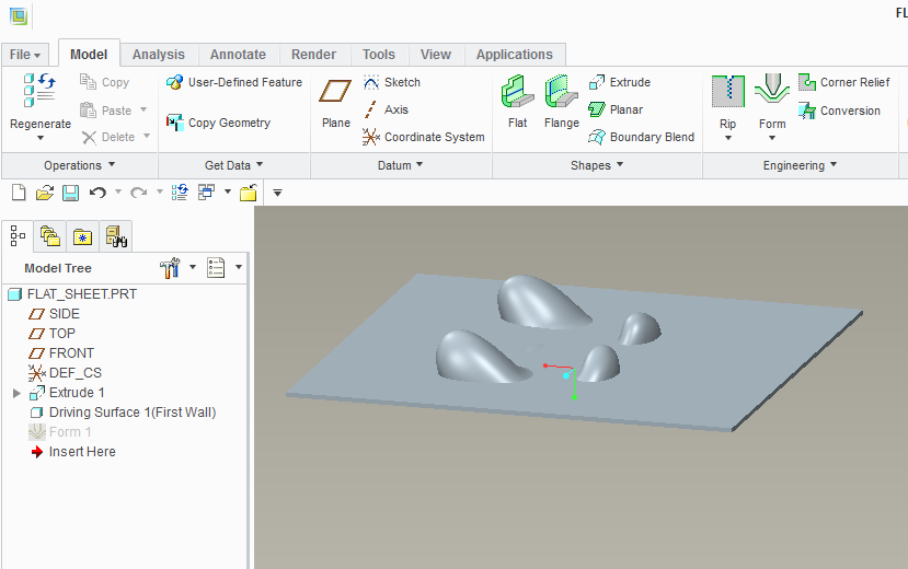

Then complete the feature...
View of the underside...
This gets tricky depending upon the geometry you're starting from. If your controller is clean and doesn't have crazy edges or angles, the sheet metal form feature can be quite deep. This should give a very close representation of a vacu-formed model.
