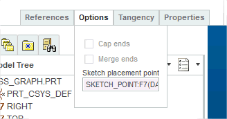

I have a VSS where I need the value of one radius to vary along the sweep from 100 at the start to 25 at half way back to 100 at the end.  Can I do this with a relation and trajpar?  If needed, I could split it into 2 sweeps where one went from 100 to 25 and the next from 25 to 100.

Hi Doug,
Yes, you can do it with a relation and trajpar. It is easiest if it is
one equation:
R = 300*trajpar^2 - 300*trajpar + 100
Is an example of a parabola that will do what you want (R is the radius
dimension).
I believe you can use IF statements to make a non-continuous curve but I
have never done this before.
If you want to do an arbitrary curve, you can use the "evalgraph" function
so that the radius is read off a sketched graph as a function of trajpar.
I can give some instructions on this if you need it.

Sounds like a graph-driven VSS might be best for your application.
A sample Creo 2 model is attached (resume all features).
A critical part of the process is to enter a sketch relation, such as the following:
sd3=evalgraph("GRAPH_1", trajpar*100)
PTCU used to have a section on driving VSS's with trajpar/graphs; ... look for the "Surfacing using Creo Parametric 2.0" course, and the section on
"Using Trajpar and Datum Graphs with Sweep Surface features".

Hi Doug,
Did Terry's model give you enough of a hint (Thanks Terry!)? To get the
equation I just started with the equation for a parabola, y = ax^2 + bx +
c and solved for a, b and c so it went through (0,100), (0.5, 25) and (1,
100) where x = trajpar and varies from 0 to 1 along the origin curve (from
start to finish, however you have defined that).
If you find the the VSS feature isn't generating for some reason,
sometimes it is because your sketch can't be resolved at all places along
the curve (. An easy way to check this is to place a datum point along
your origin curve and then placing the VSS sketch on that point.
You can then move the datum point up and down the curve and look at the
sketch at each location to see what is going on. I have done this to
Terry's file and reattached it here (in the group evalgraph_method).
