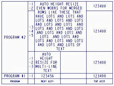

Erik,
We're not seeing either problem in our tables (Creo 2.0 M040). A sample is attached.
I experimented with dumb text and parameters and with different text justification. In all cases it seems to work as I would want. And I'm not aware of any configuration options that would affect table margins.

Mark,
I ended up opening a call with PTC tech support about this. From what we were able to determine, the automatic height adjustmentwithin merged cells will work fine with new tables on new drawings created in Creo 2. However, if it is a Pre-Creo drawing (in our case we're coming from WF4), neither new tables nor tables created from table files originating in WF4 will auto height adjust in merged cells.It also fails to work ina new in Creo 2 drawing when using a table file originating in WF4.PTC hasopened an SPR to investigate this.

PTC came just got back to me on this confirming there is a bug. However, there is a workaround. So far it has worked for me.
To correct the issue:
  1. Open the drawing
  2. File > Prepare > Drawing Properties > Detail Options change
  3. Add option as update_drawing and value as 2069392 > Add/Change > Ok
  4. Review> Update sheets > Update tables
Erik
