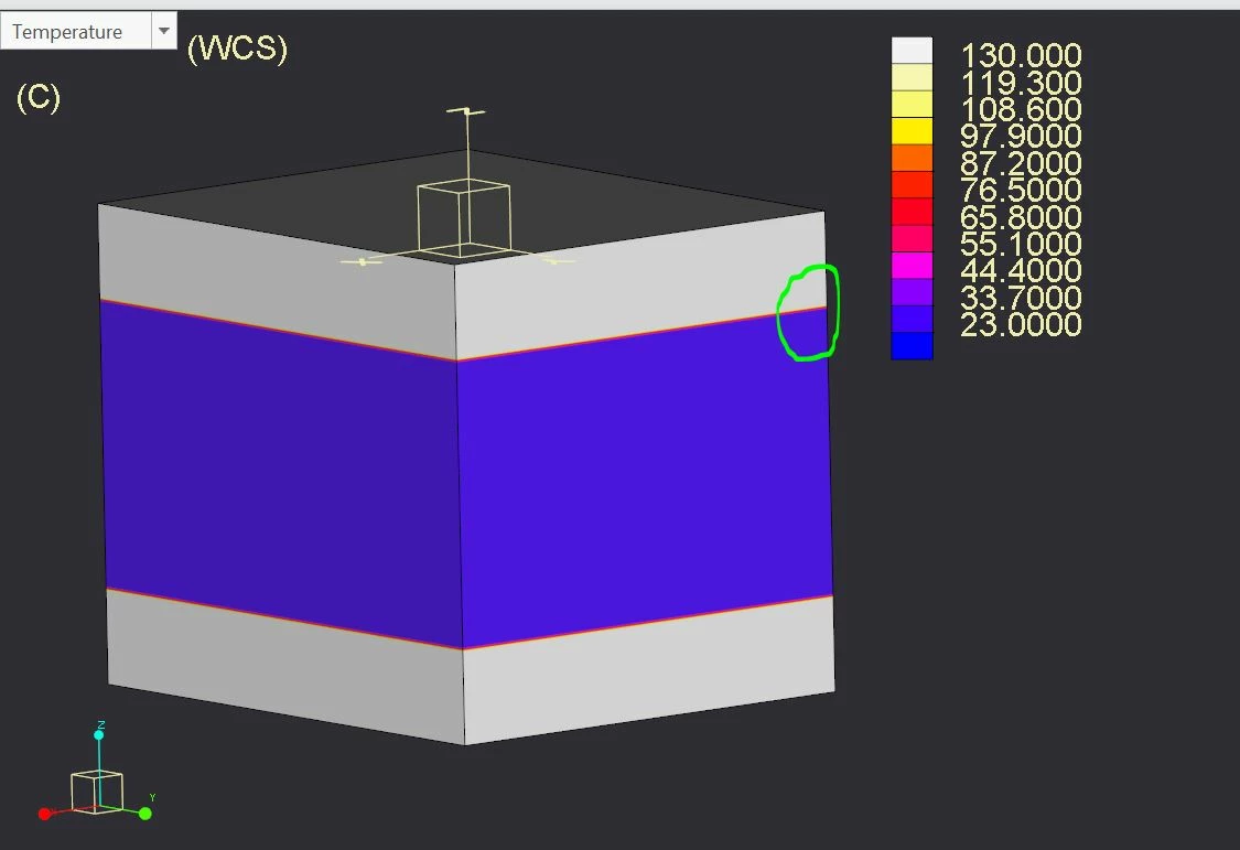

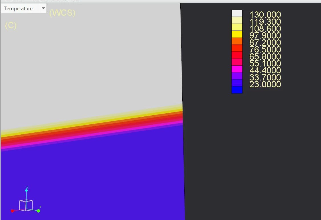

Try these files.  There was a trick with a thin volume region so the model is not discontinuous.
Top of this thin volume is prescribed 130C  bottom is prescribed 23C.  The bottom prescribed is not used for the transient study.
I had used this before but it slipped my memory.  I had trouble with the convection method and this came back to my mind.  CREO cannot do thermal resistance connection for transient analysis so in instead the thin volume is a 3D representation of thermal resistance.  You could change the material properties of that volume to adjust the resistance equivalent.
Here are the images of the initial condition from the steady state analysis.

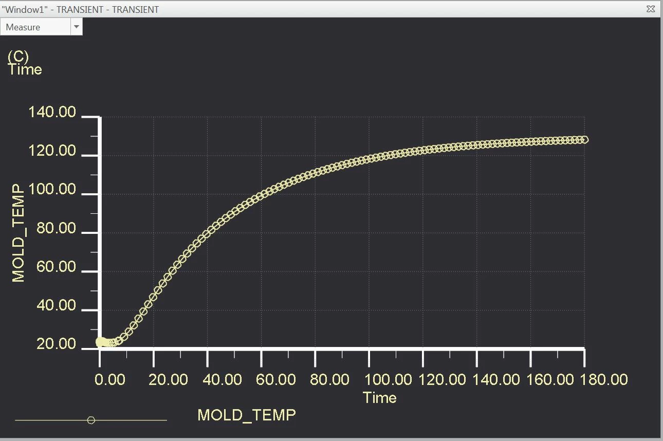

And here is a plot of the temperature vs. time at a point near the center of the mold.  It takes 7-8 seconds for heat flow to get to the center of my mold.
