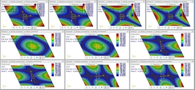

I also took the chance and practiced how to mimic unconstrained structures using constrains – as for example using 3-2-1 point constrain or, for my simple plate example, constraining a point located at CG using a weak 6DOF spring.

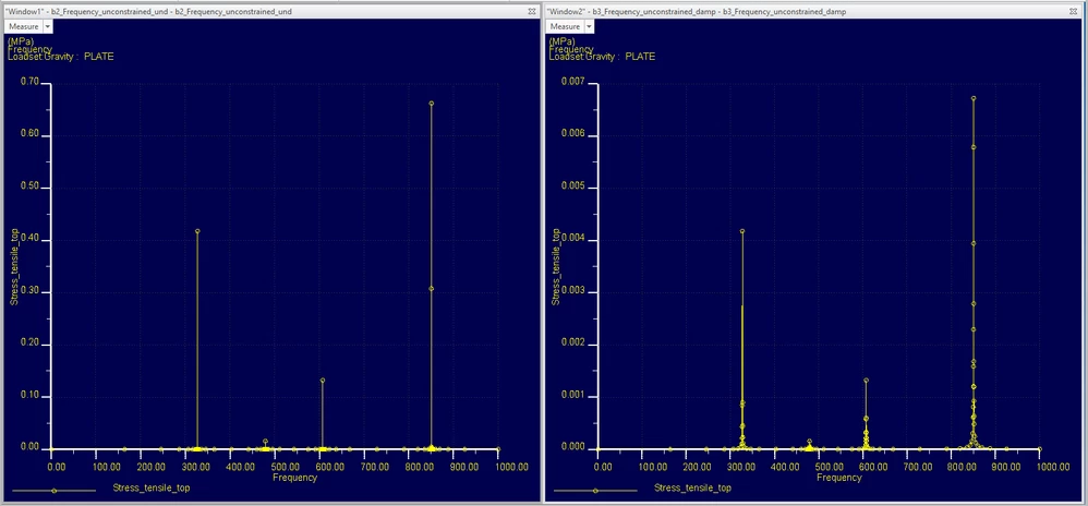

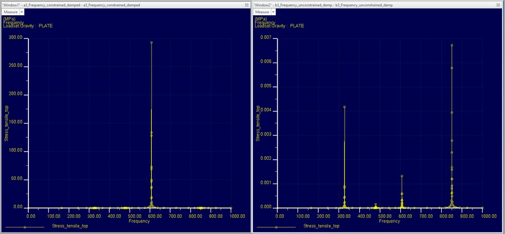

In the attached CAD model the constrained / unconstrained models have the same modal shape and eigenmodes. Nevertheless, the Dynamic frequency analysis shows very different values!
Why?!? Are the models incomparable even if they seems to show the same dynamic response? Can I really obtain reliable and physically meaningful measurements in an unconstrained structure?
Also introducing damping (even if very small – 0.01%) creates very different results among the same simulation (damping/no damping) or between constrained/unconstrained. I was surprised to see a so strong effect in the result.

If you have, different constraints (constrained / unconstrained) models you will get different dynamic behaviours! You 1st set of windows is clearly showing this. Looking at the graphs your constrained model is clearly stiffer as only one mode exists in the range up to 1000Hz. The “unconstrained” model has four modes it seems in that range !
Obviously damping/no damping will create different (peak) response at the resonance. With no damping at resonance a SDoF response is infinite (in theory)

Looking at dozen of mode shape (eigenvector) might be very boring but it’s the nature of the job. Looking at your dummy bottom graphs one would only look at mode 1 & 4 (highest response). Mode 2 is clearly not responding in the direction you are exciting your structure. Have a look and understand the use of Modal Effective Mass

I did not main to say that 3-2-1 is unconstrained - I said that it could be used to mimic the behavior of a free-free body since it will not overconstrain it. But even so, it may not match the modes. The location of a 3-2-1 constrain will change the modal shapes. This is easier to see in a plate.
For this reason I choose to constrain the CG of the plate with a very soft spring. The picture below shows the constrained and unconstrained shapes from 1 to 1000Hz. They have always the same shape.
Here the hint. Even being soft, the mode at 607Hz (mode 3) is located in the CG constrain. This amplify the bending movement in the rest of the plate instead of a translate it, as when unconstrained.
This explain why I see a peak in 607Hz for the constrained graph but not in the unconstrained one.
Also the "problem" with damping is explainable. As you pointed out it comes from "infinite" to something. Indeed a long way :-). Obviously, as my damping values gets smaller the results gets closer to the non-damping simulation. So yes, it is "very sensitive" if compared with a non-damping simulation.
